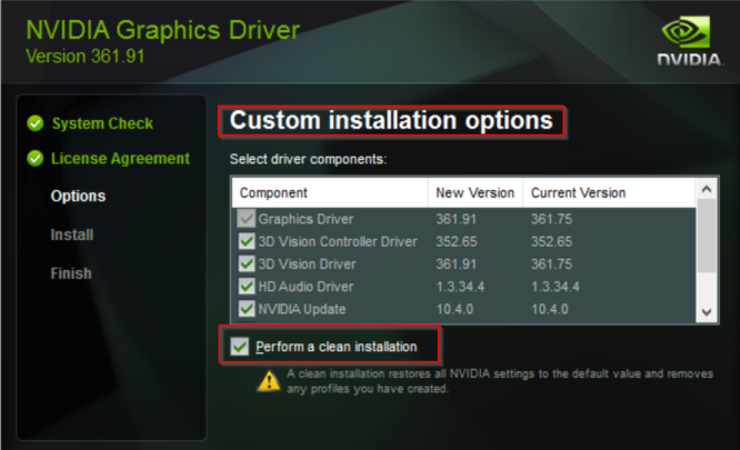

Additional Information on Driver Installations
The NVIDIA Driver Update recommendation is to use the Custom installation option and select the Perform clean installation option to validate that there are no conflicts in DLL/drivers.
