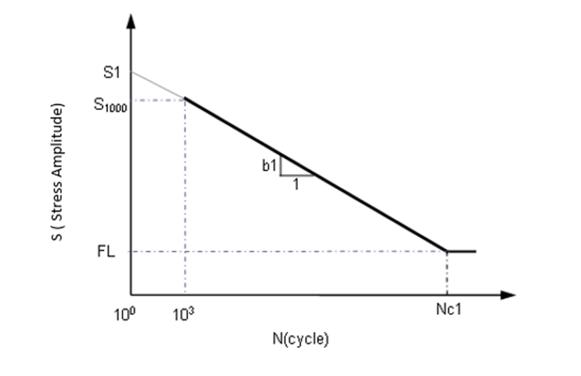

To understand these parameters, consider the SN curve as an example. When SN testing data is presented in a log-log plot of alternating nominal stress amplitude Sa or range SR versus cycles to failure N, the relationship between S and N can be described by straight line segments. Normally, a one or two segment idealization is used.
Figure 2. One segment SN curve in log-log scale
