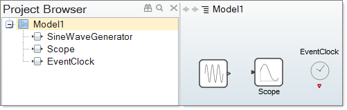

Linking Blocks in a Diagram
Connect blocks with links that extend between the ports on the blocks.
- Locate two blocks in a diagram that you want to connect.
Click the output port of the first block, then click the input port of the
second block.
A link appears between the blocks and connects the blocks together. The link includes a snapping feature that keeps the link segments straight and makes picking ports easier when connecting blocks.
