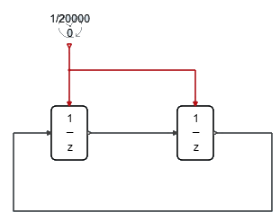

From Activate > Dynamical, drag and drop two DiscreteDelay
blocks into your diagram.
From Activate > ActiveOperations, drag and drop one SampleClock
block into your diagram.

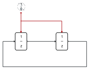

Assemble and connect the blocks in your diagram as you see in the following
figure:
On the SampleClock block, double-click. In the block
dialog, for the Sample period, enter: 1/20000, and click
OK.
On the block, DiscreteDelay, double-click. In the block
dialog, for Initial Condition, enter: 1, and click
OK.
The discrete signal is constructed as you see in the following figure. The
signal generates a square wave signal toggled between 0 and 1 at the
frequency of 10000Hz.

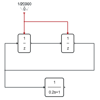

The ContTransFunc block represents a first order linear system that models
the behavior of a simplified motor dynamics.
Connect the block to your diagram as you see in the following figure:

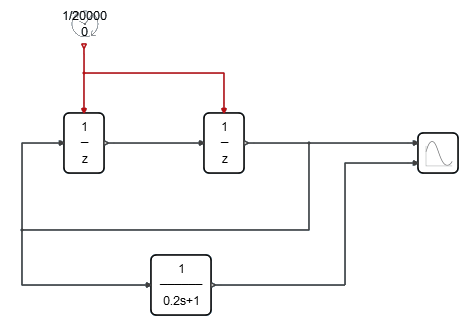

In the Palette Browser, double-click Activate > SignalViewers, and drag and drop one Scope block into
the diagram.
On the Scope block, double-click. For Number of inputs,
enter: 2.
Two input ports appear on the Scope block.
Connect the Scope block to the diagram as you see in the following
figure:

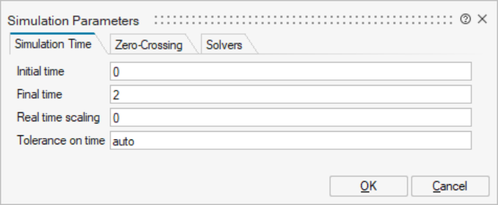

On the ribbon, select the Setup tool.
On the Simulation Parameters dialog, enter 2 for Final
time, then click OK.
On the ribbon, click Run
The simulation of the diagram begins.

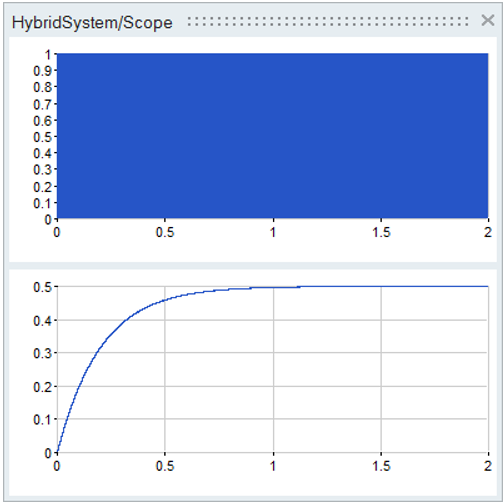

Reviewing Simulation Data
Examine the data in the plots generated from the Scope block.

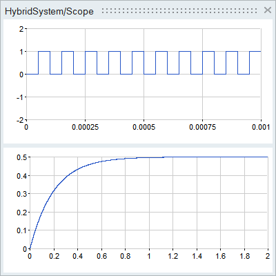

A Scope window opens. Because the Scope block is defined with two
inputs, two corresponding subplots are displayed, representing the square wave
signal and system response, respectively. Because the frequency of the square
wave is 10,000Hz, too many periods exist in the time span between 0 and 2
seconds, therefore zooming into a smaller range is required.
To reveal the square wave form more clearly, on the X-axis of the upper
subplot, right-click to launch a floating panel.
For the upper limit value, enter 0.001.
On the Y-axis of the upper subplot, right-click. In the floating panel, for the
lower-limit value, enter: -2; for the upper limit value,
enter: 2.

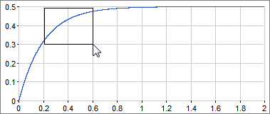

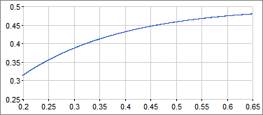

To fit the view of the plot in the window, on the lower subplot,
middle-click.
To zoom in on an area in the plot, press the Ctrl key + middle-click + drag to select a
frame on the plot.
The area in the frame appears in the lower plot as you see in the following
image:

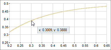

To reveal specific data points on the curve, press and hold the
Ctrl key while
positioning your cursor on the curve.
The data points closest to the cursor are displayed.
