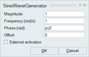

On the SineWaveGenerator block, shown highlighted in the
following figure, double-click, or right-click, and from the context menu,
select Parameters.
For the parameter Phase(rad), enter pi/2, and then click
OK.
The value you enter shifts the sine wave by a quarter period to obtain a
cosine wave.

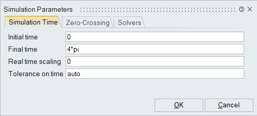

On the ribbon, select the Setup tool.
On the Simulation Parameters dialog that appears, select
the Simulation Time tab.
For the parameter, Final Time, enter
4*pi, which is twice the value of a sine wave
period.

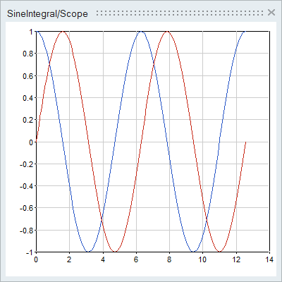

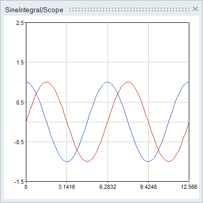

The simulation finishes very quickly, and a Scope window appears with a
plot of the simulation results. If you do not see a Scope window, double-click
the Scope block in the diagram to display the window.
The upper and lower limits of the Y-axis go far beyond the range of a unity
magnitude sine wave. To fit the Scope window to the plot data, middle-mouse
click.

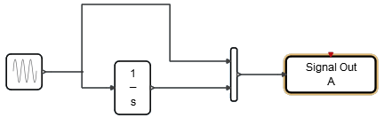

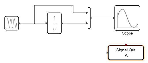

In the diagram, replace the Scope block with a SignalOut block: from the
Palette Browser, double-click the folders Activate > SignalExporters.
Select, and then drag and drop a SignalOut block next to
the diagram, but do not link it to the diagram.
Select the SignalOut block, and then press
Ctrl+
X.
Select the Scope block, and then press
Ctrl+V.
The Scope block is cleared and replaced with the SignalOut block:

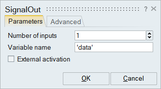

Double-click the SignalOut block.
The block dialog opens to the Parameters
tab.
As you see in the following figure, for Number of inputs, keep the default
value of 1; for Variable name, enter
'data'; if selected, clear the External Activation
check box.
Click OK.
The SignalOut block is updated in the diagram. The new variable name
appears, and the red activation port at the top of block is removed. The block
now inherits activation. If an incoming signal is present, the SignalOut block
is activated.

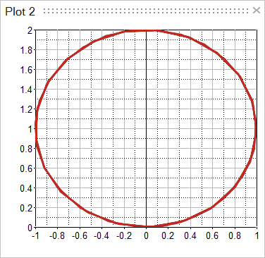

In the OML Command Window, enter the following
command to plot a curve for the data in row x in respect to row
y:
x = data.ch{1}.data(1,:);
y = data.ch{1}.data(2,:);
plot(x,y);
The
following plot appears:
