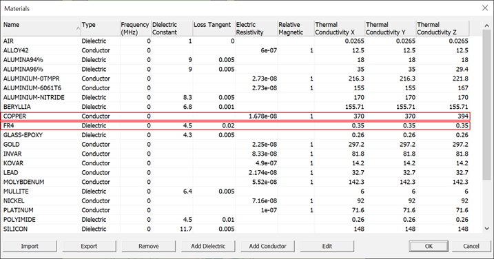

To access the Material Manager dialog, from the menu bar, select Use the dialog to add, modify, and remove certain materials and export the materials data as a Material File (*.mtrl), which could be used by import function.
Modify material properties by double-clicking a material in the Material Manager dialog or by selecting a material and clicking Edit. Click Add Dielectric or Add Conductor to open the Edit dialog.
For conducting material, you should define the electric resistivity, relative magnetic permeability and thermal conductivity along to x, y, and z axis. For dielectric material, dielectric constant, loss tangent, and thermal conductivity along to x, y, and z axis would be needed.
