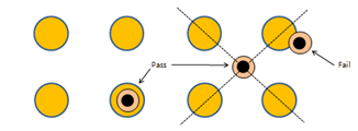

- Via Location Checking: Check the via location. Depending on the options, if
the via is placed among the center of the pins or at the same location, it
passes.
- Pass for the center of 4BGA Pins.
- Tolerance: Even if a Via Location design violation occurs, if it is within the inputted tolerance value, it is regarded as a pass.
- Pass for the same BGA Pin’s Location.

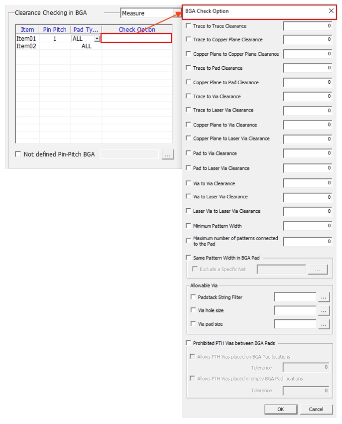

- Clearance Checking in BGA: Among defined BGA components, pick the BGA
components with certain pin pitches and specify special clearances for
different items. Set the pin pitch and double-click the Check
Option column. In the dialog, set various clearance options
and click OK to save them.
In the column, selected clearances option numbers will be displayed.

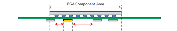

- Clearance between Components under BGA Area on BGA’s Reverse Side: For
components that are placed on the reverse side of BGA components and under
the BGA component area, use PollEx DFM to check the
clearance among them. Select the component group1, component group2, and set
the clearance values to complete rule.
