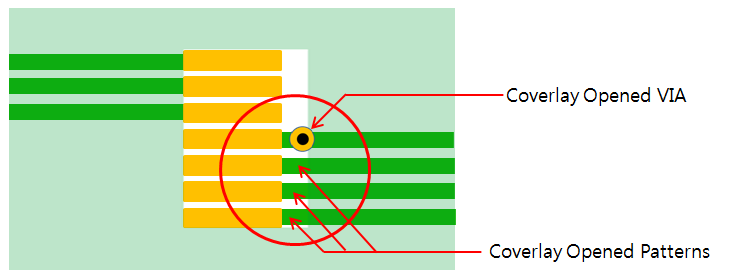

Checking: Check Coverlay opened for patterns and vias.Figure 2.
For coverlay opening, check Pattern existence: Check pattern
Coverlay opening.
Exclude Checking for Coverlay Opened for Both Sides: If
pattern Coverlay data are open in the top and bottom,
PollEx DFM will not check for
this pattern.
For coverlay opening, check Via existence: Check via Coverlay opening.
Exclude Checking for Nets: Exclude vias connected to certain
nets. To do this, select nets from
netlist.

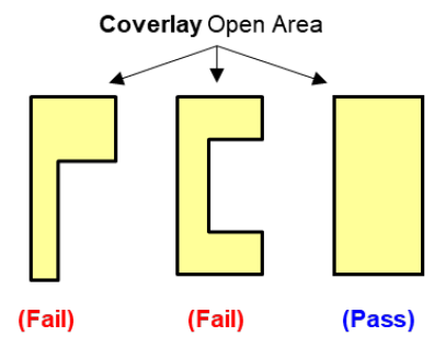

Checking if the coverlay open area is rectangle shape: Check whether
the coverlay open area is designed in a square shape in order to
prevent the coverlay film from tearing.Figure 4.
