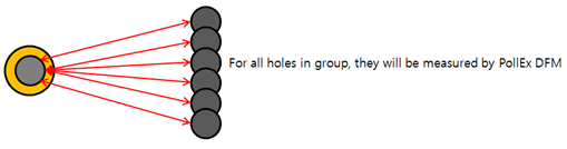

- Check Clearance with Individual Holes in Group: For grouped
holes, if this option is enabled, PollEx DFM checks all clearances between
the target hole and all individual holes in the group.

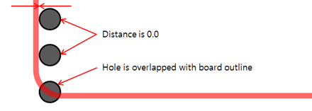

- Except for Overlapped Hole (Distance 0.0): If this option is
on, PollEx DFM skips checking for
holes overlapped with board outline.
