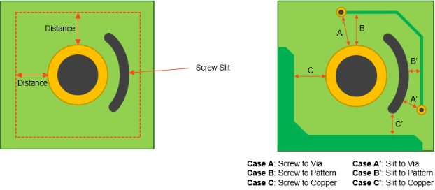

- Silt Definition
- Distance to slit area from a screw measure base: Define an area to find a slit hole.
- Silt Layer: Select a layer that is drawn in the slit hole.

- Clearance to Via: Set the clearance between the screw and via for
the top, bottom, and inner layer.
- Item: Specify the item name.
- Screw: Select a screw for analysis.
- Screw Measure Base: Select a measurement base for the screw.
- Target: Select a target object for analysis among Screw, Slit, and Screw+Slit.
- Top Clearance: Set the clearance between the screws and vias on the top layer.
- Inner Clearance: Set the clearance between the screws and vias on the inner layer.
- Bottom Clearance: Set the clearance between the screws and vias on the bottom layer.
- Clearance to Pattern: Set the clearance between the screw and
pattern for the top, bottom, and inner layer.
- Top Clearance: Set the clearance between the screws and route patterns on the top layer
- Inner Clearance: Set the clearance between the screws and route patterns on the inner layer.
- Bottom Clearance: Set the clearance between the screws and route patterns on the bottom layer.
- Except Net Segments under Pad Area: Exclude a nets existence in the component pad area during analysis.
- Except Pattern Overlapped with Copper: Exclude pattern overlapped with copper.
- Except Pattern Overlapped with Component Group: Exclude
pattern overlapped with Component specific area.
- Measure base: Select a measurement base.
- Clearance to Copper: Set the clearance between the screw and
copper-pour for the top, bottom, and inner layer.
- Top Clearance: Set the clearance between the screws and copper polygons on the top layer.
- Inner Clearance: Set the clearance between the screws and copper polygons on the inner layer.
- Bottom Clearance: Set the clearance between the screws and copper polygons on the bottom layer.
- Exclude Ground Net: Exclude the ground net from analysis by using the string filter.
- Exclude Same Net: Exclude nets connected to the screw from the analysis.
- Slit existence check: Check the existence of slits around the screws that are inspected.
