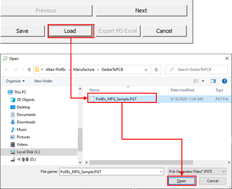

- Click Load and select the PollEx_MFG_Sample.pgt file from C:\ProgramData\altair\PollEx\<version>\Examples\MFG\GerberToPCB.
Click Open.
Click Next.

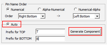

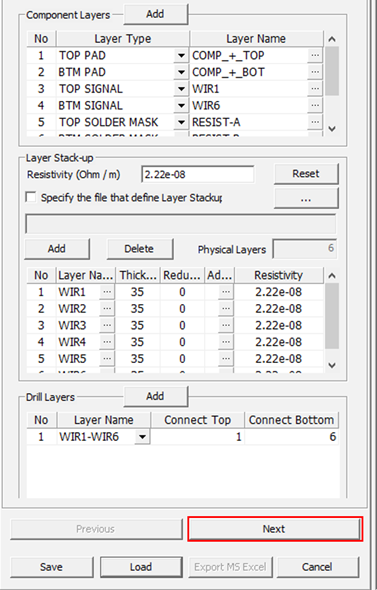

The pre-defined PCB Generator Files sets the Component Layers and Drill Layers.

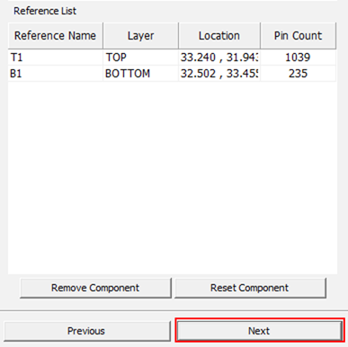

Make component.

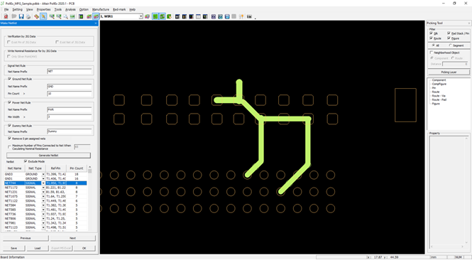

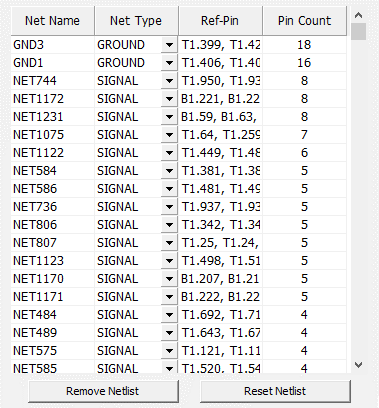

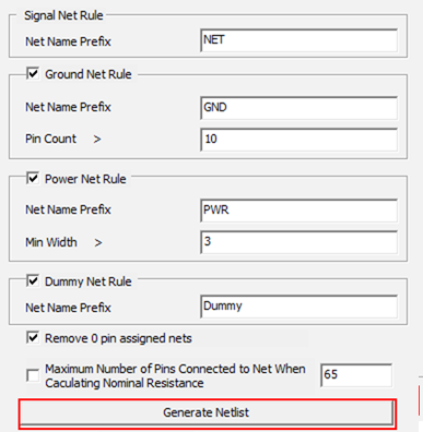

Make Netlist.

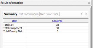

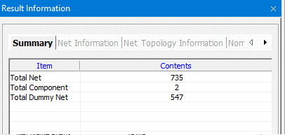

Review result information.
The result is displayed in each category such as: Summary, Net Information, Net Topology Information, and Nominal Resistance.

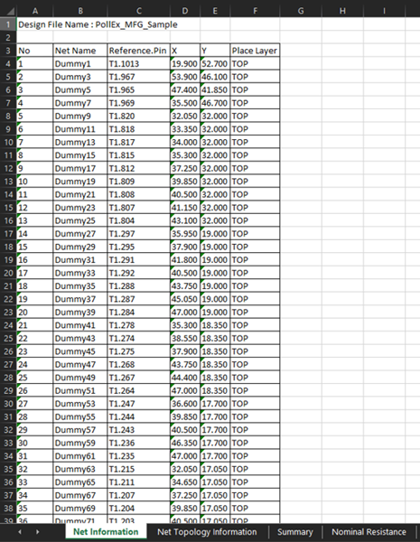

Export the result.
The result can be exported to Excel format.

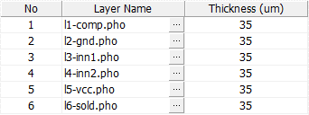

Define Layer Stack-up.
- Click Add six times.
- For 1, select l1-comp.pho for Layer Name.
- For 2, select l2-gnd.pho for Layer Name.
- For 3, select l3-inn1.pho for Layer Name.
- For 4, select l4-inn2.pho for Layer Name.
- For 5, select l5-vcc.pho for Layer Name.
- For 6, select l6-sold.pho for Layer Name.
Figure 13.

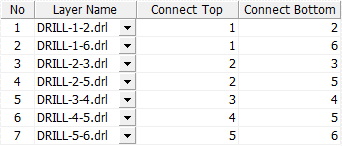

Define Drill Layers.
- Click Add seven times.
- Select layer names and enter the Connect Top and Connect Bottom values as shown in Figure 14.
Figure 14.

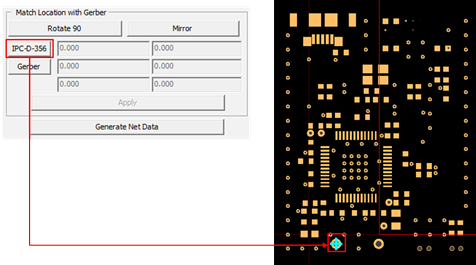

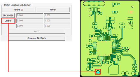

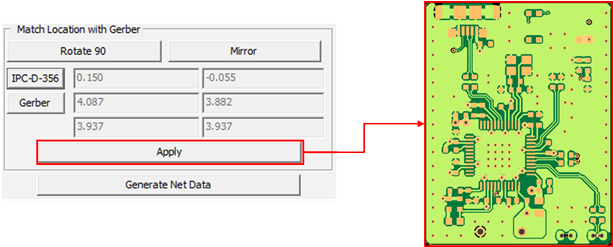

Load IPC data.
Match the Location of Gerber and IPC data.

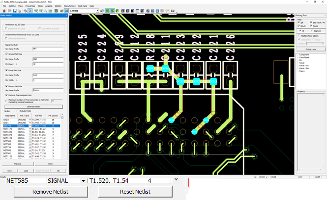

Review result.
Once the PCB design generation is completed, you can review the results of the Summary, Net Information, and Net Error Data. In each tab, a selected net from the lists will be focused and highlighted on the right-side of window for your review.
