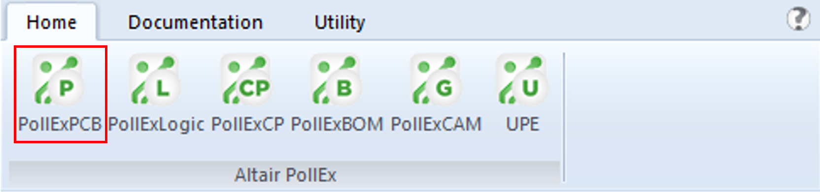

From the Home ribbon of the PollEx Launcher, click
PollExPCB.

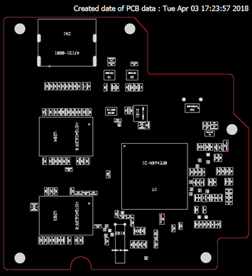

From the View tab of the menu bar, adjust the display
controls.

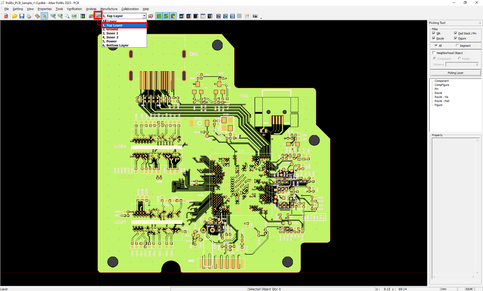

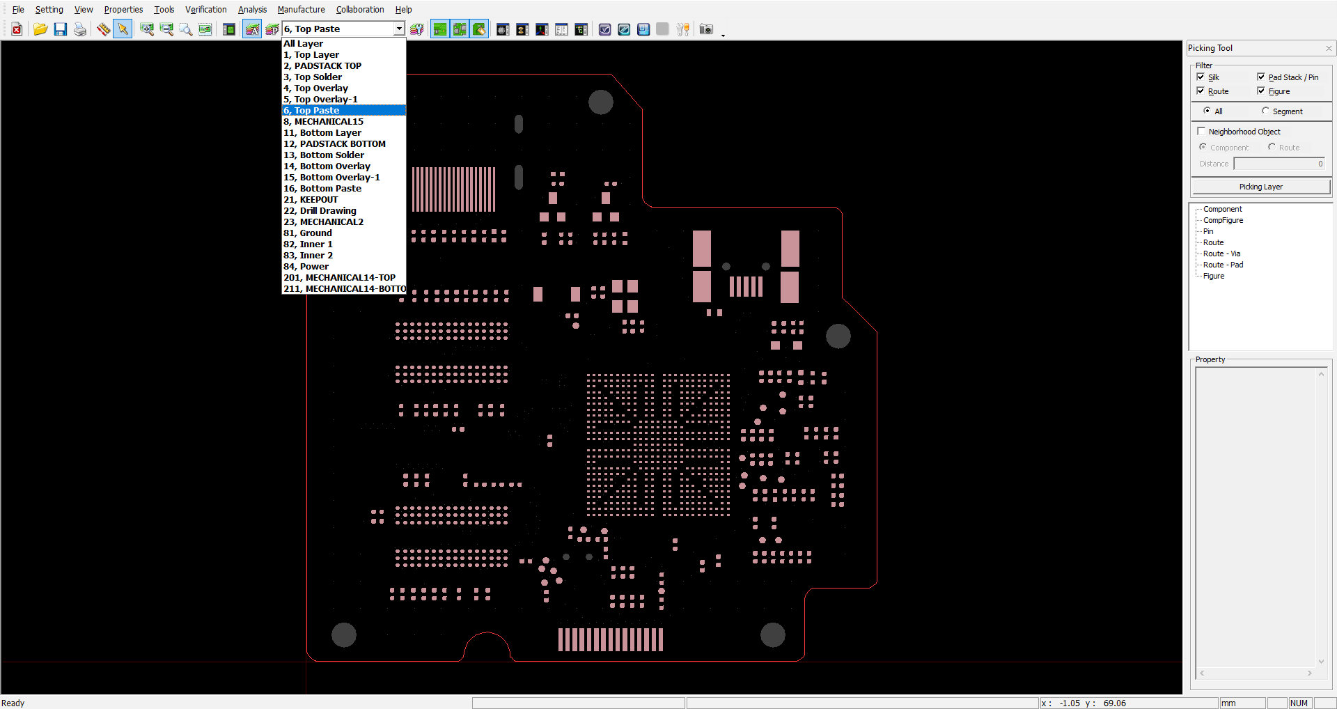

Change the layer display.
From the toolbar, click and select 6, Top
Paste.
Shape data on Top Paste displays. You can display and see the layer by
selecting the name on the list.

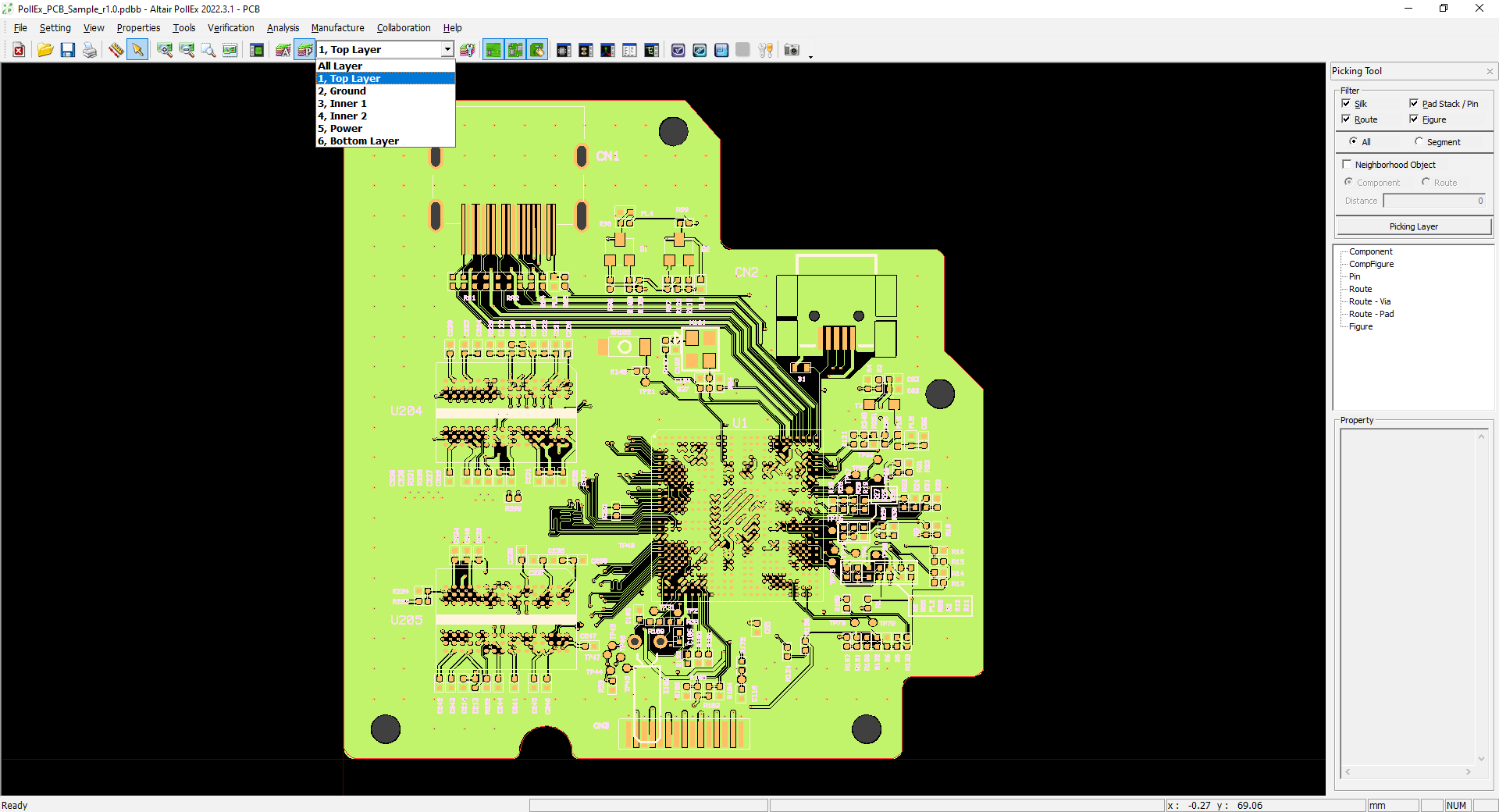

From the toolbar, click and select 1, Top
Layer.
Figure 3.
Combined layers as Top Layer is shown on the window.

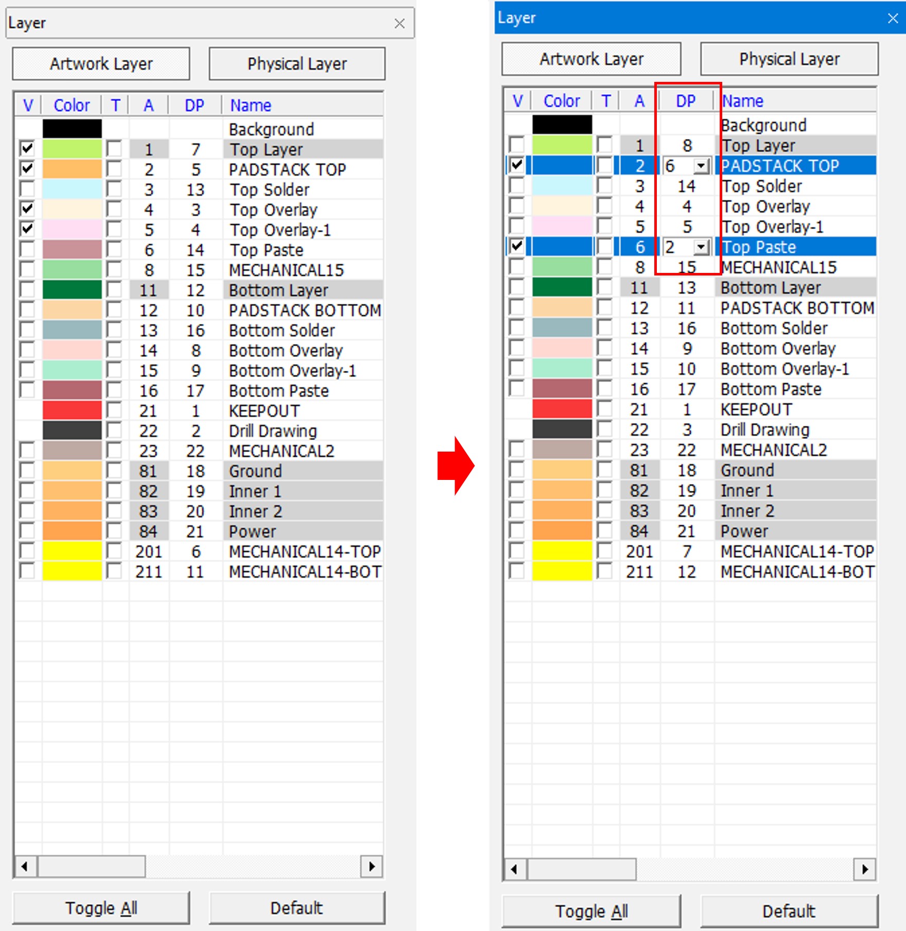

Display the target layer(s).
From the menu bar, select Setting > Layer.
In the Layer dialog, select PADSTACK
TOP and Top Paste.
For Top Paste, change the DP value to 2.
Figure 4.
Top Paste is overlapped on the PADSTACK TOP layer.
Close the Layer dialog.

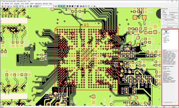

In the window, select an object within the design.
The object name and property information display.Figure 6.

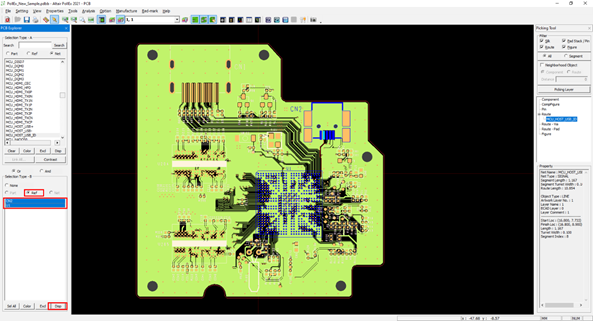

Find objects in the PCB design using the PCB Explorer.
The PCB Explorer finds parts and nets in the design data.
From the menu bar, click Tools > PCB Explorer.
From the PCB Explorer, use Selection Type A and B to check the
connected part, reference, and net name.
From the Selection Type A section, select Part, Reference, or Net and
enter a name in the search field.

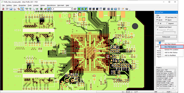

Use the Picking tool and PCB Explorer to review the connected information of
parts or nets.
In the window, select a component.
In the Picking tool window, right-click the component name and select
Run PCB Explorer from the menu bar.
Figure 7. In this tutorial, U1 is selected.
In the PCB Explorer, Selection Type – B, select
Net and click
Disp.
The selected nets with the connected component
display.

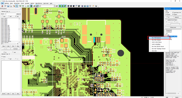

In the window, select a Net to check.
From the Picking tool, right-click the Route name and select
Run PCB Explorer from the context menu.
Figure 8. Figure 9.

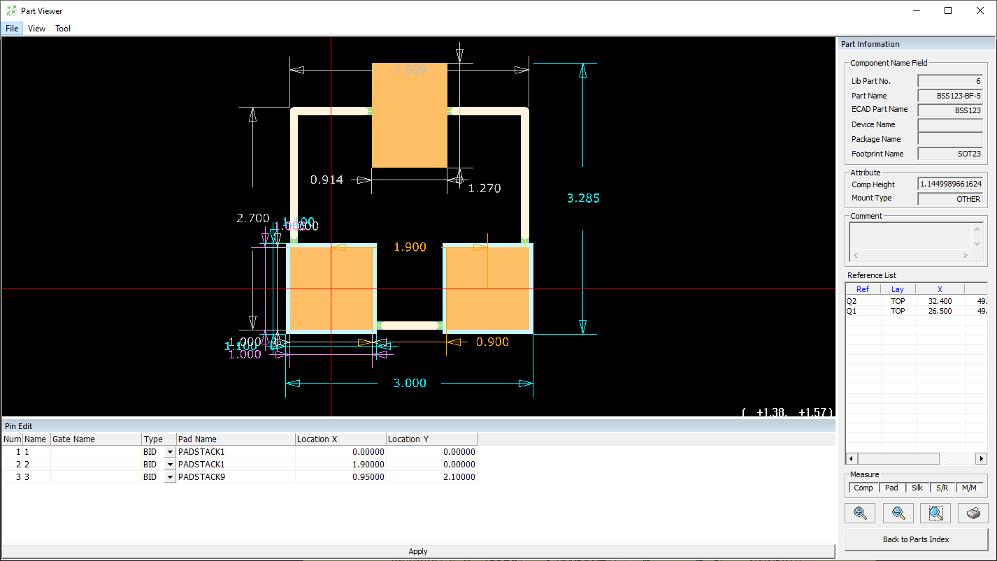

Various Object Viewers

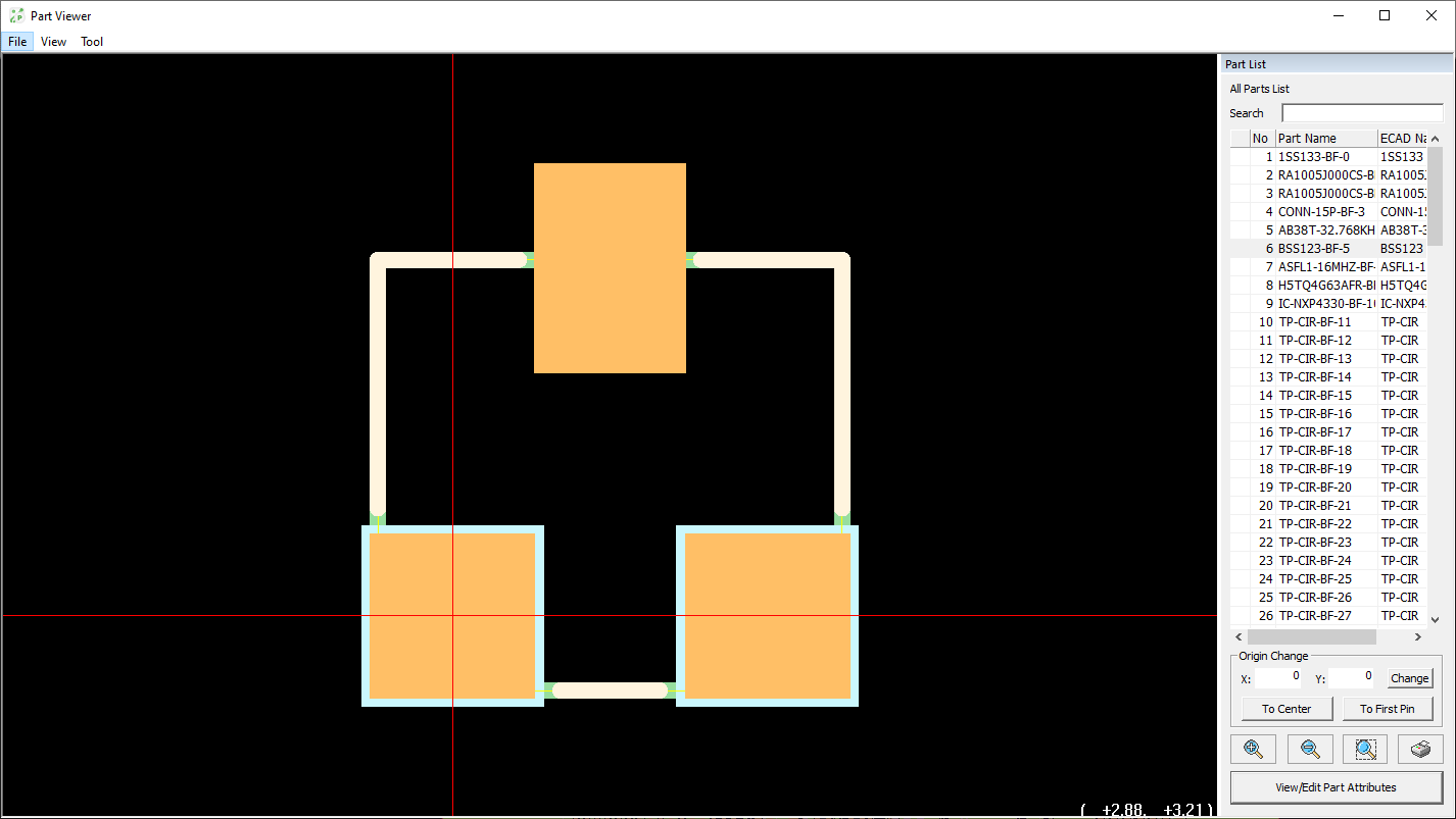

From the menu bar, click Tools > Part Viewer.
The Part Viewer dialog opens.
From the Part Viewer dialog, select a part from the part
list or use the search bar to find the desired part.
Figure 10. The selected part shape is displayed in the dialog. The red axis is the
origin point of the part, from the part library.
Once a part is selected, click View/Edit Part
Attributes.
Figure 11.
Check the pin information of the selected part by completing one of the
following options.
Check the reference name list with the same part name, Layer location,
and Layer coordinates.
Check the dimension information using the Comp, Pad, Silk, S/R, M/M
buttons.
Check the Pin name and location of the selected part.

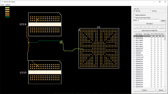

From the menu bar, click Tools > Net 2D/3D Viewer.
Use the Net 2D/3D Viewer to check nets connectivity and their
three-dimensional structures. Run the Net 2D/3D viewer to see a 2D image with
net lists and connected components, as shown in the following image.Figure 12. Use the search field to search by net name or select from the netlists. If
a net is selected, the selected net displays in the dialog. To check the net in
3D, select 3D View from the 2D/3D section.
Check the net structure and properties.
Select 3D View from the 2D/3D section.
From the net list, select MCU_ABAO.
Rotate the selected net by completing one of the following
options:
Use the arrow buttons in the Net 3D Viewer Rotation menu.
Move your mouse while holding left-mouse click.
Click Property.
Click each item under MCU-ABAO to see each structure in the net routing
pattern.
Close the Net 2D/3D Viewer dialog.

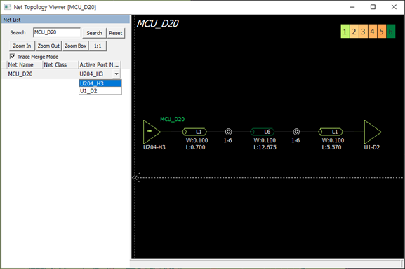

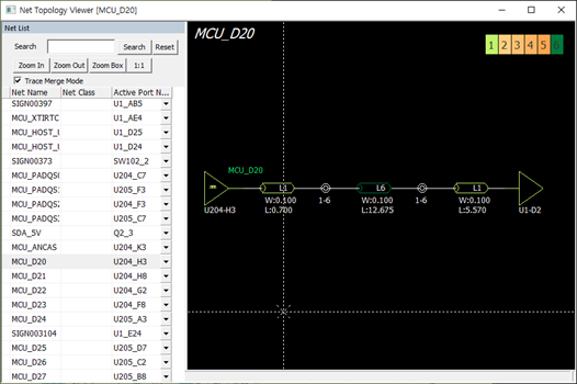

From the menu bar, click Tools > Net Topology Viewer.
The Net Topology Viewer dialog opens.
Use the Net Topology Viewer to
check a net with a topology structure (Driver-Load-Receiver) including
connected Vias and Branches. The viewer configures the net length and width
of a trace and a component by displaying different colors per
layer.
From the Net List, select MCU_D20.
Figure 13. MCU_D20 displays as the topology structure with the following parameters:
: placed layer and color
Driver
W: net width
L: net length
Change the Active Port Name to U1_D2.
Figure 14.
Close the Net Topology Viewer dialog.

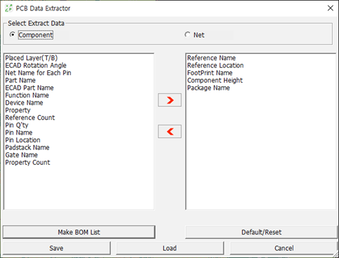

The PCB Data Extractor generates a document of component and net information that can
be exported as an Excel file.
Use the PCB Data Extractor to export component and net information.
From the menu bar, click Tools > PCB Data Extractor.
The PCB Data Extractor dialog
opens.
Use the red arrows to move items to be documented from the left column
to the right.
Figure 15.
After the necessary items are selected, click Make BOM
List.
The PCB Data Extractor Result dialog
opens.
To export an Excel file, click Export to
MS/Excel.
To export Net information (Net length, connected via, total via
numbers, and so on), select Net in the
PCB Data Extractor dialog and repeat steps
1.b –
1.d.

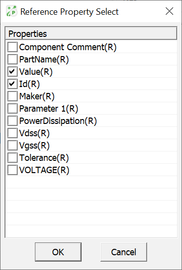

The Reference Property Select dialog
opens.
Enable the checkboxes of the necessary properties to be included in the
document and click OK.
Figure 16.
The selected properties display in the right
column.

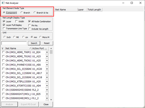

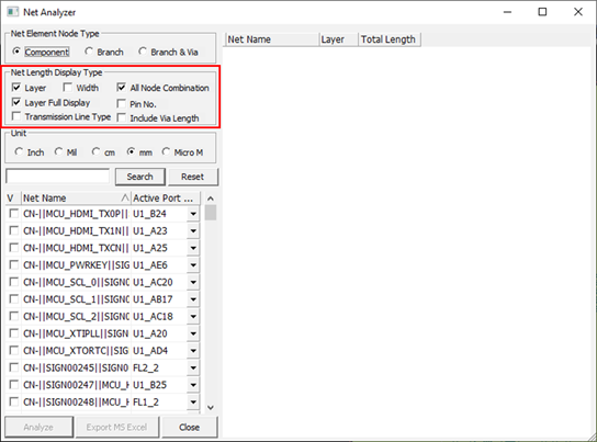

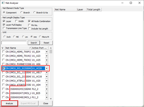

Use the Net Analyzer tool.
The Net Analyzer is used to analyze all net length information by considering
Layer, Branch, and Via location.
From the menu bar, click Tools > Net Analyzer.
The Net Analyzer dialog opens.
From the Net Analyzer dialog, verify the Net
Element Node Type is set to Component.
Figure 17. Net Element Node Type options:
Component: net length among components.
Branch: net length among components, including length of
branched points.
Branch & Via: net length among components, branching points,
and vias.
Select at least one item to be displayed.
Figure 18. Net Length Display Type options:
Layer: display net length by a layer.
Width: display routing pattern width.
All Node Combination: display all combination of nodes.
Layer Full Display: display stack-up information and net length
by a layer.
Pin No: display component pin number.
Transmission Line Type: display lengths of micro strip line and
strip line.
Include Via Length: display via information.

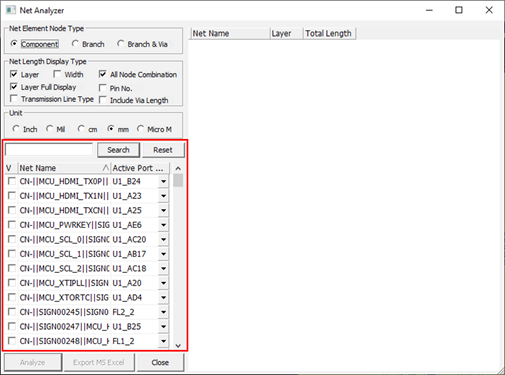

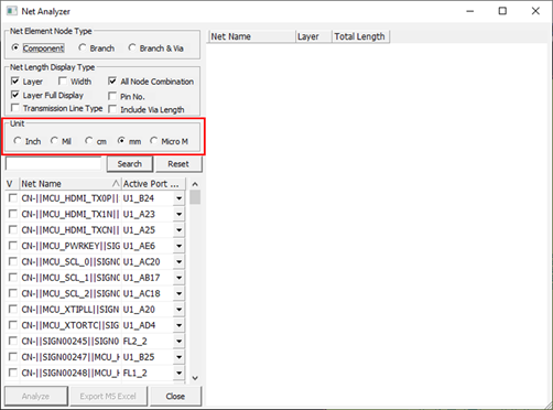

Select a display unit.
Figure 19.
Use the search bar to find the desired net name.
Figure 20.

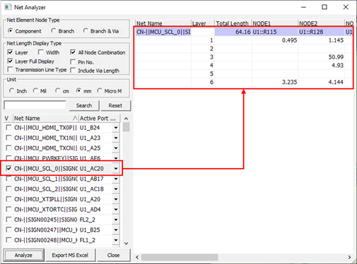

Enable the checkbox of the desired Net and click
Analyze.
Figure 21. The length information of the selected net displays.Figure 22.
To make a report, click Export MS Excel.

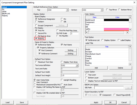

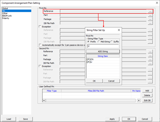

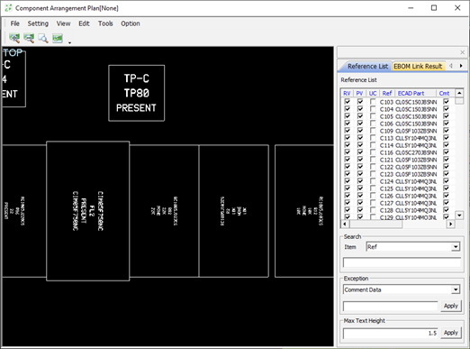

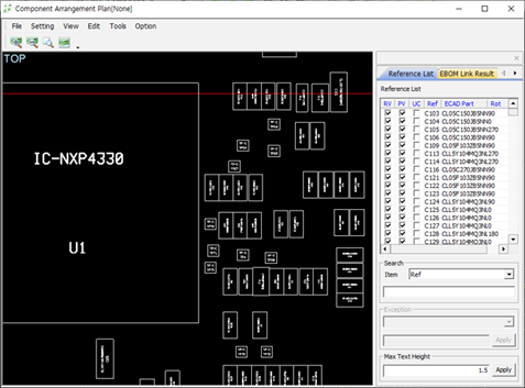

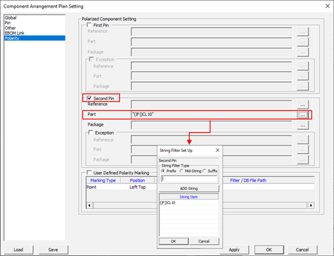

Use the Component Arrangement Plan tool to create a work-plan sheet. Using the
created format, you can also apply this format to other designs to make another work-plan
sheet.

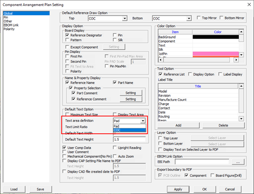

From the menu bar, click Tools > Component Arrangement Plan.
Click Setting > CAP Data Setting.
The Component Arrangement Plan Setting
dialog opens.

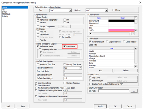

In the Component Arrangement Plan Setting dialog,
enable the Part Name checkbox and click
OK.

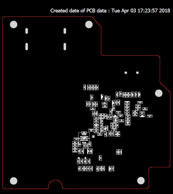

Figure 23. The part name displays in the Component Arrangement
Plan dialog.Figure 24.

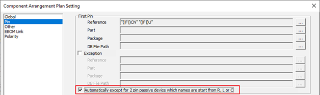

From the Component Arrangement Plan dialog
menu bar, click Setting > CAP Data Setting.
dialog opens.

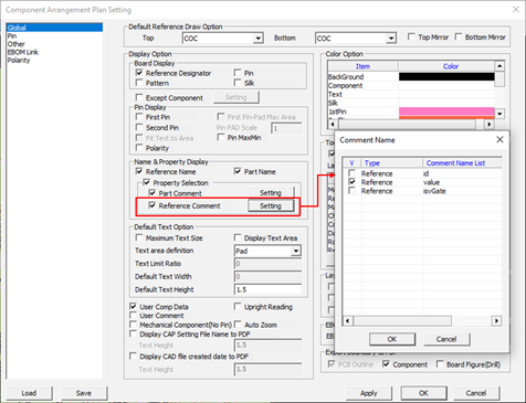

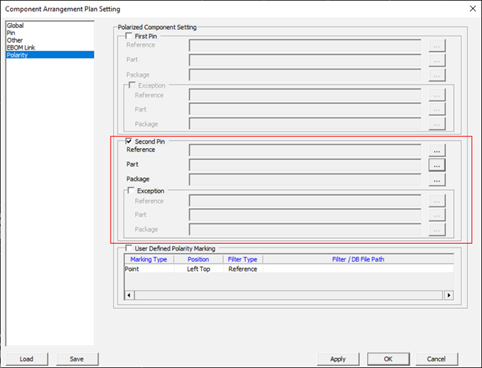

From the Component Arrangement Plan Setting
dialog, enable the Property Selection
checkbox.
From the Comment Name dialog, select the value and
click OK.
If there is no value in the part property, you can select value
in Reference Comment as shown below.Figure 25. Figure 26.
dialog, select COC for Text Area Definition and click
OK.
Figure 27. The text for reference name and value is displayed in the COC
area.
Display first pin location.
menu bar, click Setting > CAP data setting.
dialog opens.
Select Pin.
At the end of the Reference field, click the ellipses.
The String Filter Set Up dialog
opens.
From the String Filter Set Up dialog, enter
U and CN for reference
prefix recognition.
Figure 28. References with names starting with U and CN are shown with their
1st pin location.
enable the Automatically except for 2 pin passive device
which names are start from R, L or C checkbox and click
Global.
Two pin components that have a reference name starting with ‘R, L, C’
will not display in the 1st pin’s location.Figure 29.
From the Pin Display section, enable the First
Pin checkbox and click OK.
Figure 30. References with names starting with U and CN are shown with their
1st pin location.
Display component polarity.
For components with polarity like a capacitor, you can display their
polarity.
dialog opens.
select Polarity.
Enable the Second Pin checkbox.
Figure 31.
Click the ellipses at the end of the Part field.
opens.
In the String Filter Set Up dialog, enter
CL10, press Enter, and
click OK.
Figure 32. This displays the polarity on the second pin of the part whose
part name starts with CL10.
Select Global, enable the Polarity checkbox from
the Pin Display section, and click OK.
Figure 33.

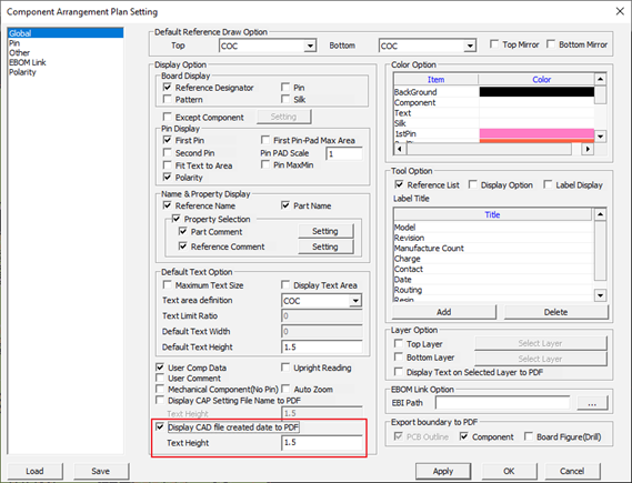

Output completed work-sheet.
dialog opens.
enable the Display CAD file created date to PDF
This option shows the design creation date.Figure 34.
menu bar, click File > Print.
The Print Option dialog opens.
From the Print Option dialog, select
PDF and enable the Top and
Bottom checkbox.
Verify the Paper Size is set to A4 and click
OK.
Figure 35.
Specify a save location, enter a file name, and click
Save.
A worksheet for the top and bottom is output into a PDF file Top
side worksheet. Bottom side worksheet.
Top side worksheet.Figure 36. Bottom side worksheet.Figure 37.

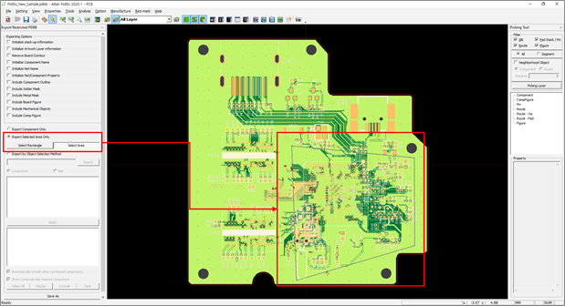

From the Export Restricted PDBB menu, select Export Selected
Area Only and click Select
Area.
In the window, draw an area to save and press
Enter.
Figure 38.
From the Export Restricted PDBB menu, click Save
As.

From the PollEx Launcher, Home ribbon, click the
PollExPCB.

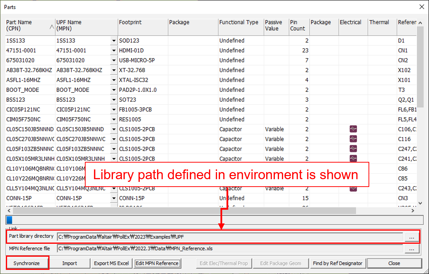

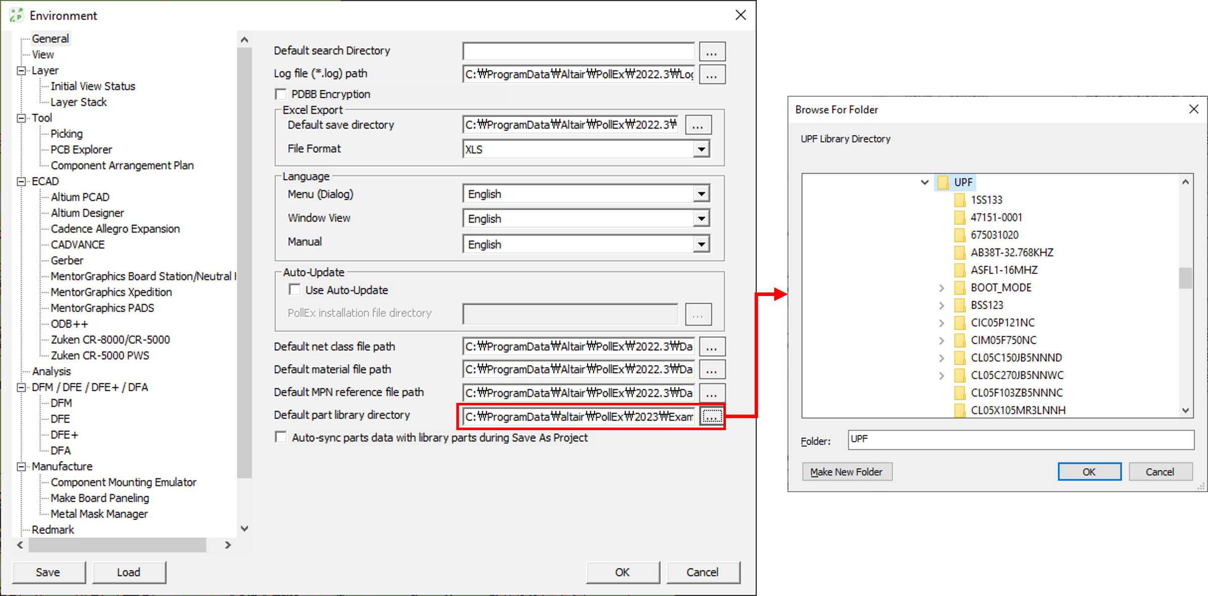

Link components.
From the menu bar, click Setting > Environment.
The Environment dialog opens. You can set
the environment for importing 3D part libraries.
From the Environment dialog, click the ellipses at
the end of the Default part library directory field to define the
default 3D part librarian path.
Define the unified part library directory found here:
ProgramData\altair\PollEx\<version>\Examples\UPF.
Figure 39.
Click OK.
From the menu bar, click Properties > Parts.
The Parts dialog opens.
From the Parts dialog, click
Synchronize.
Figure 40.
The image below shows the parts linked status.Figure 41.
: Linked to 3D packages
: Linked to electrical buffer
model
: Linked to package thermal
libraries
Click Close.

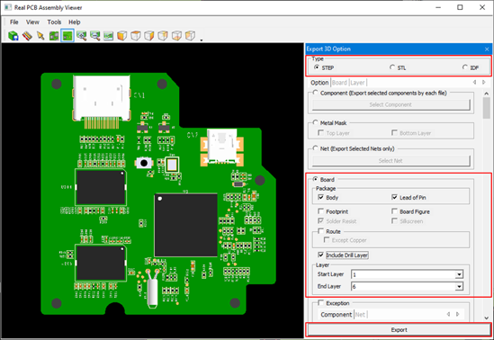

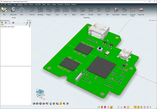

Export to 3D Format. Designs can be exported in the following formats: STEP,
STL or IDF.
In the Real PCB Assembly Viewer dialog, click File > Export To > 3D Format.
The Export 3D Option dialog
opens.
From the Export 3D Option dialog, select an export
type, define the board settings, and click
Export.
Figure 42.
Specify a location, enter a file name, and click
Save.
Use a mechanical CAD or MCAD system to read the exported STEP
file.Figure 43.
