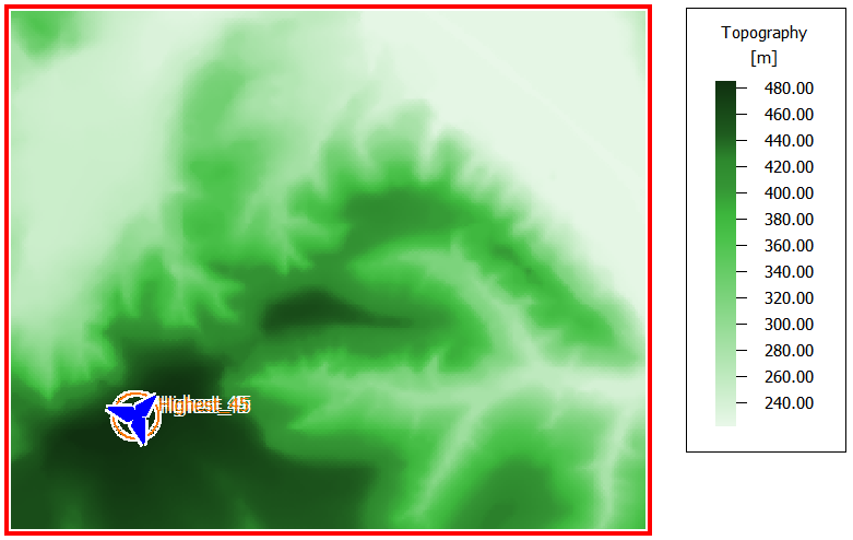

In the 2D view, the mouse cursor is displayed as a circle to indicate that the Set site tool is enabled.
Place the cellular base station with a left-mouse click on the highest hill in
the model, at or near (X, Y) = (513628, 5400187), as indicated in Figure 2.
Figure 2. Location of the first cellular base station. The base station is located on the highest hill.

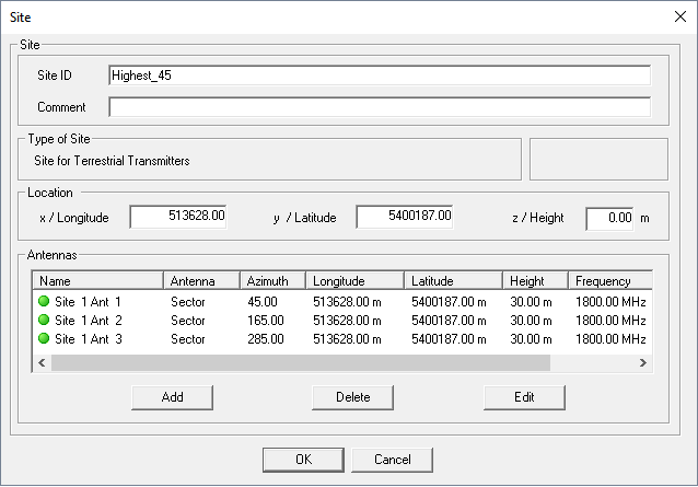

Note: The exact coordinates are not important for this example, but the above location is used in the steps that follow.The Site dialog is displayed.Figure 3. The Site dialog.
- In the Site ID field, change the label to Highest_45.
- Under Location, in the z/Height field, enter a value of 0 m.
Click on Site 1 Antenna 1 to select and click
Edit.

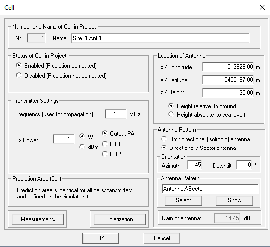

The Cell dialog is displayed for antenna 1.
- Under Transmitter Settings, in the Frequency (used for propagation) field, enter a value of 1800 MHz.
- Under Location of Antenna, in the z / Height field, enter a value of 30 m.
- Under Antenna Pattern, click Directional / Sector antenna.
- Under Orientation, in the Azimuth field, enter a value of 45°.
- Under Orientation, in the Downtilt field, enter a value of 0°.
Select to browse to the file
Sector.apb1.
Note: Sector.apb is an antenna pattern created in AMan.
Click OK to close the Cell
dialog.
Figure 4. The Cell dialog for antenna 1.
Repeat Step 7 to
Step 14 to define
antenna 2.
- For the antenna orientation, change Azimuth to 165°.
Repeat Step 7 to
Step 14 to define
antenna 3.
- For the antenna orientation, change Azimuth to 285°.
- Click OK to close the Site dialog.
