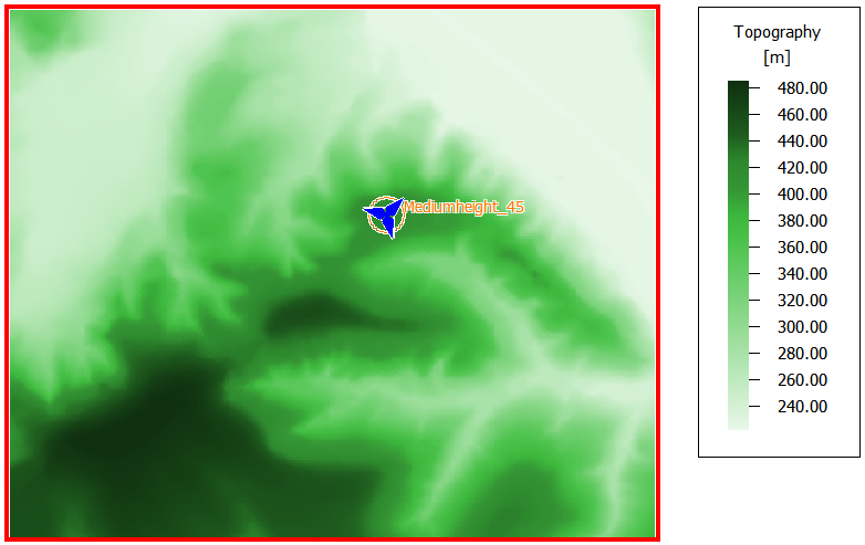

  4. Place the cellular base station with a left-mouse click on a lower hill closer to town in the model, at or near (X, Y) = (516000, 5402142) as indicated in Figure 2.
    Figure 2. Location of the second cellular base station. The base station is placed on a lower hill.
    Note: The exact coordinates are not important for this example, but the above location is used in the steps that follow.

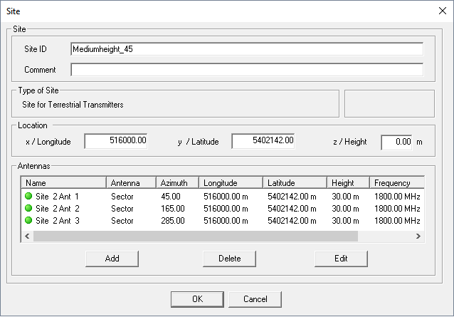

    The Site dialog is displayed.
    Figure 3. The Site dialog.
  5. In the Site ID field, change the label to Mediumheight_45.
  6. Under Location, in the z/Height field, enter a value of 0 m.

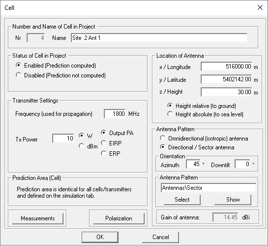

    The Cell dialog is displayed for antenna 1.
  8. Under Transmitter Settings, in the Frequency (used for propagation) field, enter a value of 1800 MHz.
  9. Under Location of Antenna, in the z / Height field, enter a value of 30 m.
  10. Under Antenna Pattern, click Directional / Sector antenna.
  11. Under Orientation, in the Azimuth field, enter a value of 45°.
  12. Under Orientation, in the Downtilt field, enter a value of 0°.
  13. Under Antenna Pattern, click Select to browse to the file Sector.apb1.
    Note: Sector.apb is an antenna pattern created in AMan.
  14. Click OK to close the Cell dialog.
    Figure 4. The Cell dialog for antenna 1.
  15. Repeat Step 7 to Step 14 to define antenna 2.
    1. For the antenna orientation, change Azimuth to 165°.
  16. Repeat Step 7 to Step 14 to define antenna 3.
    1. For the antenna orientation, change Azimuth to 285°.
  17. Click OK to close the Site dialog.
