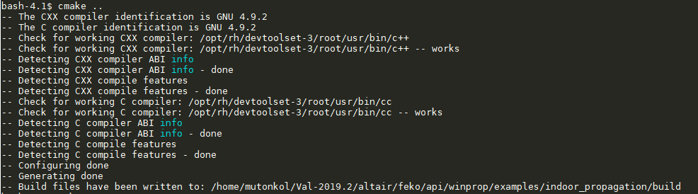

Set up the project and create a make file by executing:
cmake ..Figure 1. A sample of the output after executing cmake.

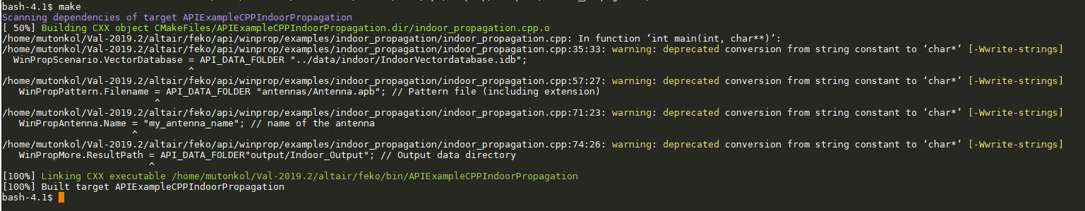

Compile the code in indoor_propagation.cpp by
executing:
makeFigure 2. A sample of the output after the code was compiled.
