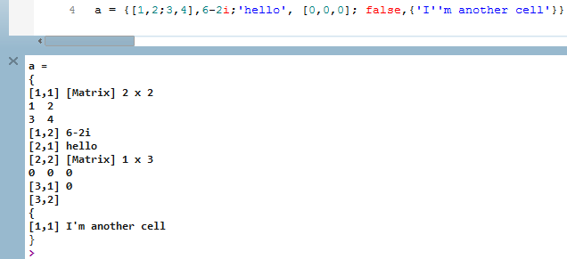

Creating a Cell
From the Editor window, enter the following line in a
new OML script:
a = {[1,2;3,4],6-2i;'hello', [0,0,0]; false,{'I''m another cell'}}
This creates a cell where:a (1,1)
is the matrix [1,2;3,4]a (1,2)
is the complex number 6-2ia (2,1)
is the string 'hello'a (2,2)
is the vector [0,0,0]a(3,1)
isfalse
, which is a kind of Booleana(3,2)
is another cell which only contains one string element‘I’m another cell’
Click Run to view the output:

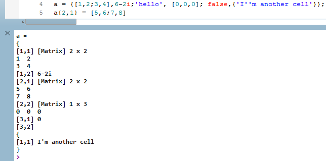

Modifying an Element in a Cell
To reference a particular element in a cell, use
a{x,y}
with a being the name of the cell andx
andy
being the row and column, respectively. If you want to modify the element ina{2,1}
add the following:a{2,1} = [5,6;7,8]
Click Run to see the following results:
In this case, we see that the element at [2,1] was changed from the string
'hello'
to the matrix [5,6;7,8].

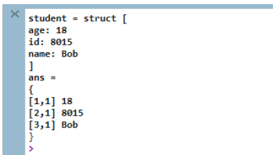

Convert a Struct to a Cell
struct2cell
. The original struct’s fields change to
the number index, as shown
below:student.name = 'Bob';
student.age = 18;
student.id = 8015
% transfer a struct to a cell
struct2cell(student)
This returns:

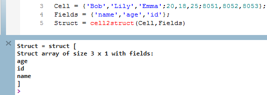

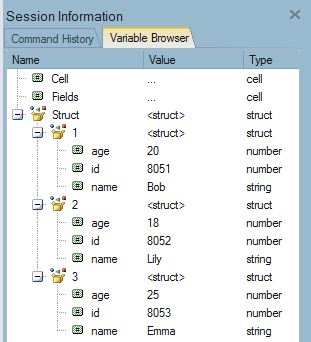

Convert a Cell to Struct
Cell = {'Bob','Lily','Emma';20,18,25;8051,8052,8053};
Fields = {'name','age','id'};
Struct = cell2struct(Cell,Fields)
This script converts a cell to a struct with the fields name, age, and id respectively:
Click +
in front of Struct in the Variable Browser to expand this struct. The Variable Browser displays this:
