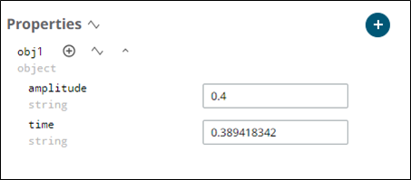

It is possible to see that the data sent from Compose is being received on IoT Studio using the MQTT protocol.

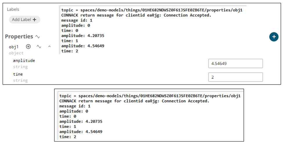

Considering that Compose is subscribed to the topic, if any message is sent from one device to that topic, Compose receives it:It is possible to see that the data sent from IoT Studio is being received on Compose using the MQTT protocol.
