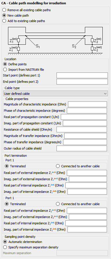

In the Solve/Run tab, in the Cables group,
click the
Irradiating cable
(CA) icon.
Parameters:
- Remove all existing cable paths
- If checked, all previously defined cable paths are removed. All the other input parameters are ignored.
- New cable path
- Defines a new cable path, all previously defined cable paths are replaced.
- Add to existing cable paths
- An additional cable path is defined (for example, the previously added ones will be kept).
- Location
- The location of the cable path section can be specified as two points or imported from
a NASTRAN file.
- Define points
- The Start point and the End point of the cable path section are defined by point names. These points must have been defined previously with a DP card (or by an external import).
- Import from NASTRAN file
- The name of the NASTRAN file and the property ID of the segments that have to be imported are required to import the cable path section.
- Cable type
- This specifies the type of cable. There are two possibilities: User defined cable or a
predefined cable from the internal Feko cable database:
- If User defined cable is selected
- The user has to enter all the cable properties in the Cable
properties section which will then be enabled. The units of the
individual parameters are included in the description. Note: That the Outer radius of cable shield will be scaled by any active SF card.Also keep in mind that most of these parameters may depend on the frequency and thus one might use variables or expressions.
- If a predefined cable type is selected
- The section containing the cable properties will be disabled, and all required parameters will be retrieved automatically from an internal Feko cable database. There are several commonly found shielded cable types (up to now all coaxial cables) included.
- Port termination
- This section is used to define the ports (for example, the two ends of the cable path section defined by this CA card). For each port the user can decide if it is terminated by an (internal and external) impedance or if this end of the cable path section shall be connected to another cable path section.
- Sampling point density
- The cable path section will be subdivided into small segments for the computation of the induced currents and voltages. The electric and magnetic field strengths will be evaluated at each segment’s centroid, so this setting influences the accuracy of the computed result, but also the computation time. The setting Automatic determination will choose the segment length automatically (which should be adequate for most cases). If the maximum separation distance is specified, then this value will override the automatic mechanism. Note that this manual value will be scaled by any active SF card.
