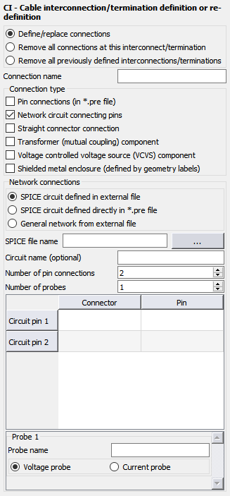

CI Card
The CI card is used to define interconnections and terminations between cables.
In the Solve/Run tab, in the Cables group,
click the
Interconnect cable
(CI) icon.
Parameters:
- Define/ replace connections
- New connection, replaces previous connections with the same name.
- Remove all connections at this interconnect/termination
- All previously defined connections (with this name) at this specific interconnection/termination are removed.
- Remove all previously defined interconnections/terminations
- All previously defined interconnections/terminations are removed.
- Connection name
- The name of the connection.
- Pin connections (in .pre file)
- The connection between pins are specified in the .pre file.
- Pin
- The pin number identifies the conductor associated with the cable path section as defined by Connector label in the CS card. If the pin is set to 0, the connector pin is connected to the local circuit device ground. If the pin is set to -1, the connector pin is connected to the global installation.
- Loading
- The following loading options between two pins are available: direct short, open, complex, series RLC, parallel RLC circuit and a 1-port Touchstone load specified in either a .s1p, .z1p or .y1p file.
- Probes
- A voltage and/or current probe may be placed between two pins.
- Network circuit connecting pins
Note: This option is not supported in conjunction with a closed metallic surface.
- Spice circuit defined externally and directly in .pre file
- A SPICE circuit is connected between multiple pins. The SPICE circuit can be
provided as an external file or it can be included directly into the
.pre file.
- SPICE file name
- The file name of the SPICE circuit to be connected between two pins. The file name is required when the SPICE circuit is loaded from an external file, but should not be used when entering the SPICE circuit directly in the .pre file. When the SPICE circuit is included directly in the .pre file, a field will be displayed where the circuit can be entered.
- Circuit name (optional)
- The main sub-circuit name to be used from the .cir file. If left unspecified, the name should match the sub-circuit name.
- Number of pin connections
- The number of pin connections to be made.
- Number of probes
- The number of voltage and/or current probes.
- Connector
- The label of the connector to be connected to the SPICE circuit.
- Pin
- The pin of the connector to which the SPICE circuit will be connected to.
- Probes
- The type of probe, either voltage or current.
- General network from external file
- A Touchstone network is connected between multiple pins. The general network is
provided as an external file with S, Y or Z parameters.
- Touchstone file name
- The file name of the Touchstone network to be added to the cable schematic.
- Number of ports
- The number of ports in the general network.Note: There are two pin connections for each port definition.
- Connector +
- The label of the connector to be connected to the general network.
- Connector -
- Pin +
- The pin of the connector to which the general network will be connected to.
- Pin -
- Straight connector connection
- This option is used when similar cables are connected.
- Number of connections
- The number of connections between similar cables.
- Connector
- The label of the connectors of the cables which will be connected.
- Transformer (mutual coupling) component
- This option is used when a transformer is connected in a circuit.
- Number of transformer components
- The number of transformers connected between similar cables.
- Coupled inductor
- Specify the connections for coupled inductor 1 and 2 of the transformer component.
- Inductance
- The inductance of the coupling inductor in Henry.
- Connector
- The label of the connector which the positive or negative pin of the coupling inductor is connected to.
- Pin
- The pin of the connector to which the positive or negative pin of the transformer coupling inductor is connected to.
- Phase dot position
- Select at which pin (positive or negative) the phase dot is positioned at for the coupling inductor.
- Coupling
- Specify the coupling coefficient (K) a value greater than 0 and less than or equal to 1.
- Probes
- The type of probe, either voltage or current for coupling inductor 1 and 2.
- Voltage controlled voltage source (VCVS) component
- This option is used to specify the connection of the voltage controlled voltage source
in a circuit.
- Number of VCVS components
- The number of VCVS components between similar cables.
- Connection pins
- Connector
- The label of the connector which the positive or negative pin of the VCVS is connected to.
- Pin
- The pin of the connector to which the positive or negative pin of the VCVS is connected to.
- Control pins
- Connector
- The label of the connector which the positive or negative pin of the control (measurement) pin or is connected to.
- Pin
- The pin of the connector to which the positive or negative pin of the control (measurement) pin is connected to.
- Control voltage
- Specify the Voltage gain for the VCVS.
- Probes
- Closed metallic surface (defined by geometry labels)
- Note: This option is not supported in conjunction with network circuit connecting pins.This option is used to connect combined MoM/MTL cable paths to the same harness using a closed metallic surface with a label.
- Number of combined MoM/MTL paths
- The number of the combined MoM/MTL cable paths terminating on the metallic surface.
- Number of labels
- The number of geometry labels that define the closed metallic surface.
- Labels
- The list of geometry labels that define the closed metallic surface.
- Connector name
- All circuit connections should be made to this connector name and pin 0.
