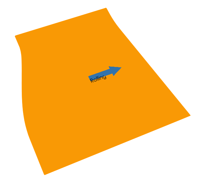

Define the Roll Direction
Define the direction of the coil of sheet metal from which the blank was cut.
From the Tryout ribbon, click the Blank icon.
- Define the Blank Type and Material and Define Symmetry.
Click on the blue Rolling arrow to define the roll
direction of the blank for efficient stamping. Use the microdialog that appears
to define further parameters. You'll achieve the most accurate calculation if
you input the direction that the coil was rolled.
