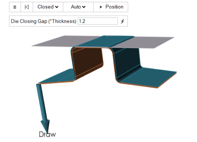

A guide bar opens with three fields. - In the first field, select a tool state for the die set: Open or Closed. Choose Closed to modify the die in the closed position.
Use the guide bar to configure the die. Click the
to
modify the Die Closing Gap (*Thickness). If you want to
return to Inspire Form's default settings for the tool gap, click on the
lightning bolt
