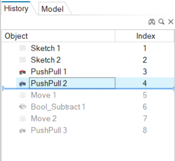

Roll Back and Roll Forward

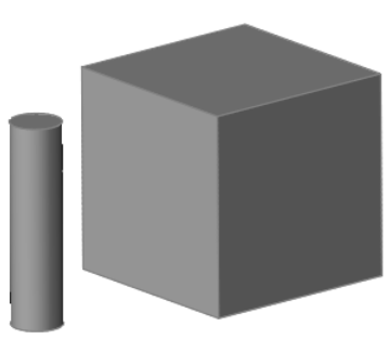

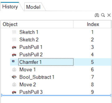

Add a new construction feature at an earlier point in the model’s construction history.
In the History Browser, move the blue end marker to the point where you wish to
add a new construction feature.
- Use one of the tools on the Sketch or Geometry ribbons to add modify your geometry. This will add a new construction feature.
Move the blue end marker to the bottom of the History Browser.

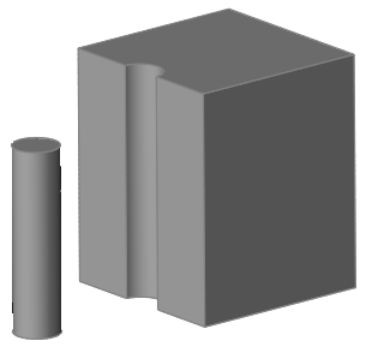

Note: You can also use the end marker to advance through the model’s construction history step by step.In the example above, we added a chamfer to the top of the cylinder prior to the Boolean subtract construction feature. Inspire Form automatically recomputes the subsequent Push/Pull construction feature, taking the added chamfer into account. Note that the top of the cylindrical cutout is conical in the final model.

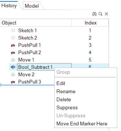

Context Menu Options
The right-click context menu in the History Browser contains the following options for editing the construction history.
