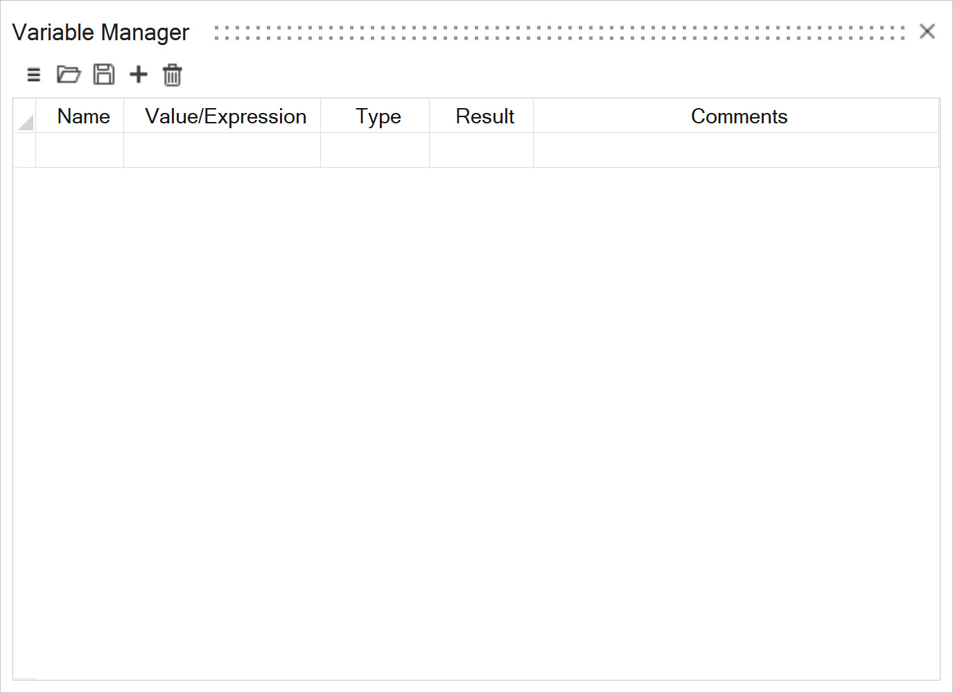

Manage Variables Using the Variable Manager
Use the Variable Manager to edit variables, create new variables, and import or export variables in .csv format.
On the Geometry ribbon, select the Variables tool.
The Variable Manager is displayed.
You can do the following:

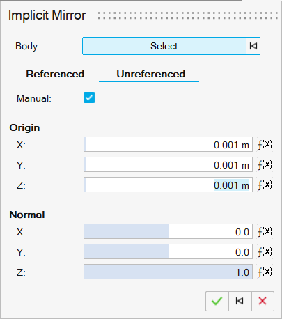

Create or Assign a Variable to Parametrize your Model
Create or assign a variable to parametrize your model. Variables can be created from a tool or the tool’s microdialog where f(x) is present.
You can create or assign existing variables via the microdialog or in various tools.
In the tool or the tool’s microdialog, click the f(x)
icon.
Figure 1. Example of a microdialog with a variable field
Figure 2. Example of a tool with a variable field
- In the dropdown menu, select Create Variable to create a new variable based on the type in the text field, or select the name of an existing similar type variable to assign it.
