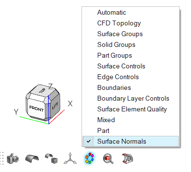

From the View Controls toolbar, set the model color to Surface
Normals to see the existing normals.
