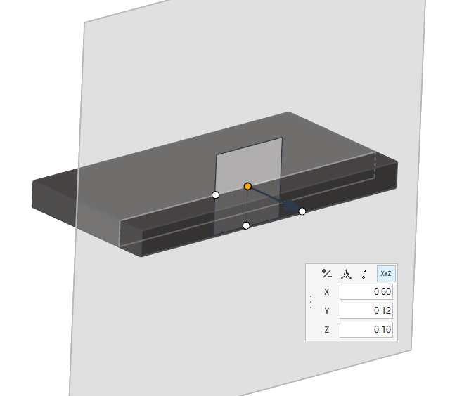

Define Nodal Initial Conditions
From the Solution ribbon, click the
Plane tool.
Figure 14.
- Select the solid body.
- Click Plane on the guide bar.
- Click any point on the model to initially position the plane.
Click
in the microdialog and
manually set the plane axis to Y.
Figure 15.
Click
and set the coordinates to (0.60, 0.12,
0.10).
Figure 16.
- Press Esc two times.
