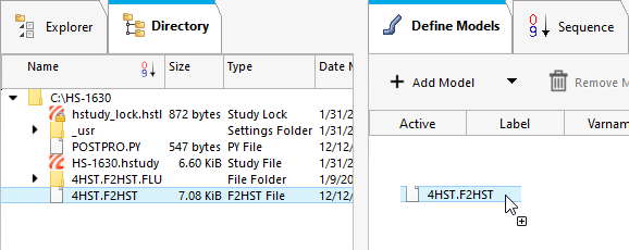

    1. From the Directory, drag and drop the 4HST.F2HST file into the work area.
      Figure 4.
    2. Click Import Variables.
    HyperStudy creates a Flux model, imports eight input variables and one response from the Flux file, and populates the Solver Execution Script and Solver Input Arguments tabs.

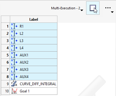

    1. Click the Objectives/Constraints - Goals tab and select Add Goal.
    2. Verify the goal is applied on Curve_DIFF_INTEGRAL (r_1) and the type is set to Minimize.
      Figure 5.
    3. Click Evaluate.

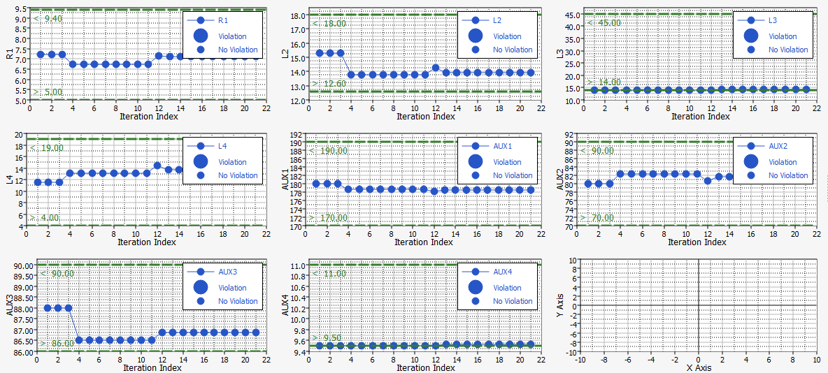

  4. Optional: Display the plots of the dvs variations vs the iterations.
    1. Go to the Iteration Plot tab.
    2. From the Channel Selector, display the plots for R1 through AUX4.
    3. Select Multiplot.
      Figure 6.
    4. Click Options, and select Bounds from the drop-down menu.
    5. Right-click on one of the plots, and select All > Legend from the context menu.
    6. Analyze the plots to determine if the allowed bounds have been reached. As indicated in the figure below, only the L3 min bound is reached.
    Figure 7.
