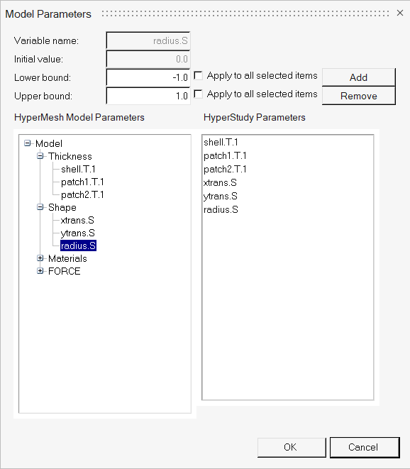

In the Model Parameters dialog, add variables as shown in
Figure 1 and click
OK.

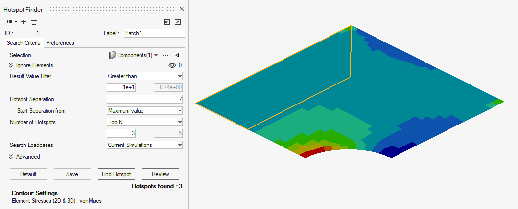

Query Patch1 hotspot by repeating step 6.
- For Label, replace Shell with Patch1.
- In the modeling window, select the Patch1 component.
Figure 3.

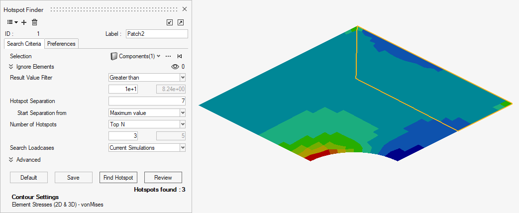

Query Patch2 hotspot by repeating step 6.
- For Label, replace Shell with enter Patch2.
- In the modeling window, select the Patch2 component.
Figure 4.

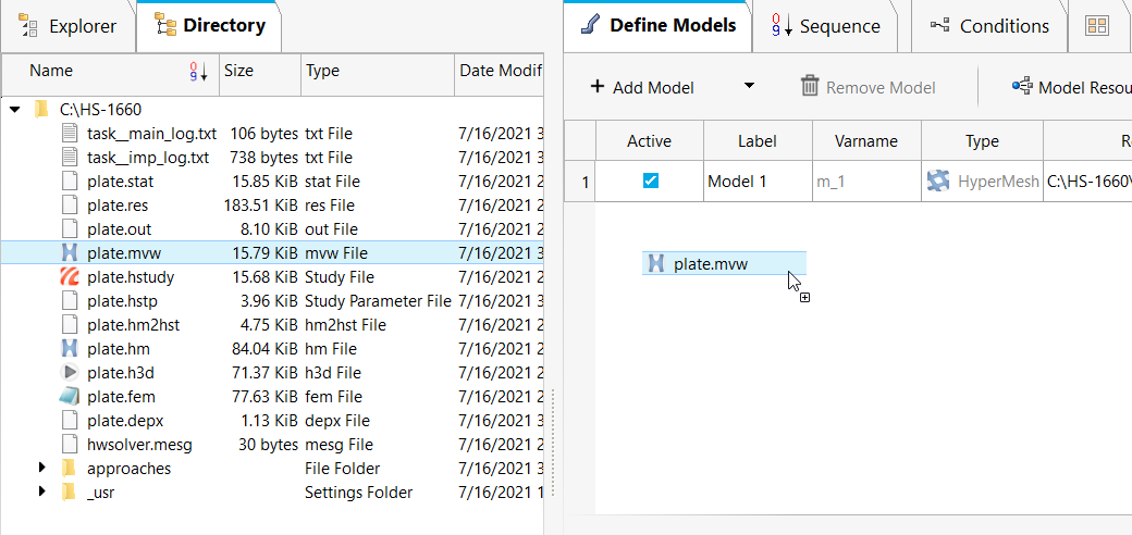

From the Directory in HyperStudy, drag-and-drop the
plate.mvw file into the Define Models area.
Figure 5.

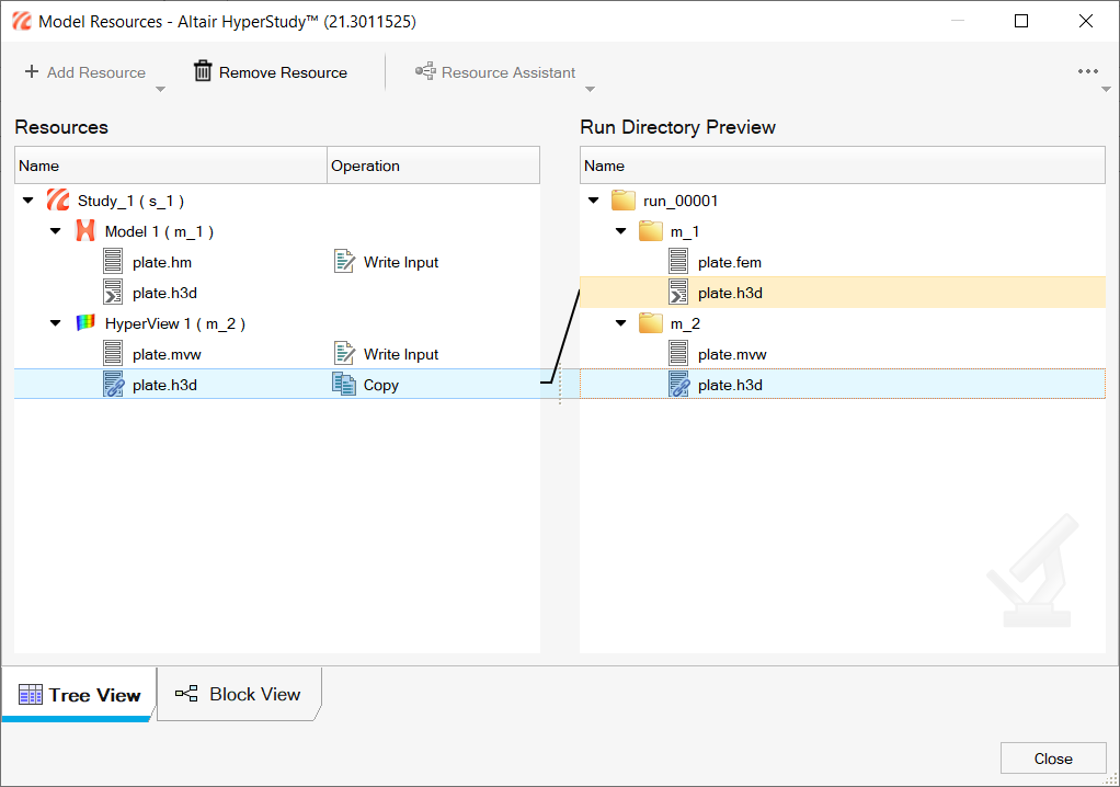

In the Define Models area, click Model Resources.
The Model Resources dialog opens.
In the Model Resources dialog, define a model dependency
that references the result file from m_1 directory,
plate.h3d to be used as an input for the HyperView model.
- Select Model 2 (m_2).
- Click .
- In the Select File dialog, navigate to the m_1 directory and add the plate.h3d file.
- Set the plate.h3d operation to Copy.
Figure 6.
- Close the Model Resources dialog.
