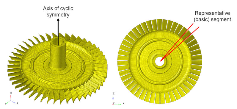

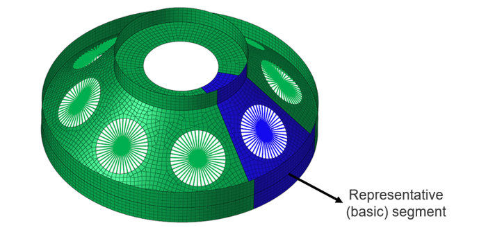

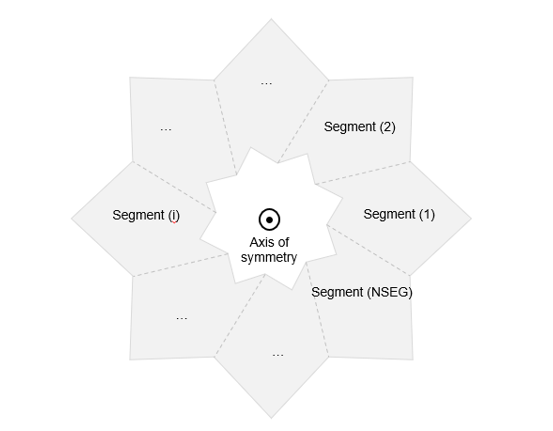

Cyclic symmetry is a type of symmetry in which a representative (or basic) segment, if patterned circularly about an axis of symmetry would result in the full model.

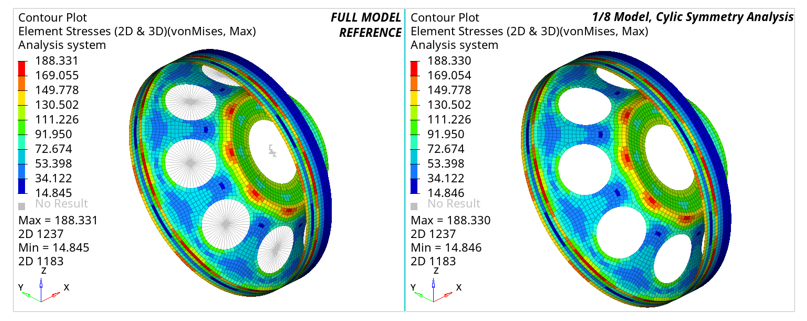

Structures with symmetry can often be modeled with one representative entity, from which the full structure can be obtained after certain operations (pattern, mirror, rotation, etc.). Such methods can lead to huge savings in modeling effort, computational time, and file storage. Therefore, exploiting symmetry in finite element models could prove to be very advantageous.
- The basic segment could either be the smallest repeating unit in the model or could involve several repeating units.
- Depending on your requirements, a full 360 degree model or a partial (as in, 270 degrees) model could be analyzed by suitably specifying the number of segments in the model definition.

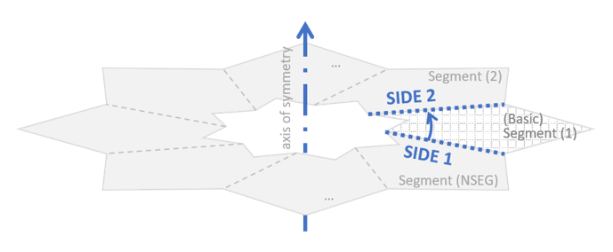

In a cyclic symmetry analysis, the boundaries on either side of the modeled base segment which are to be connected to adjacent segments are defined as SIDE 1 and 2. The direction of the axis of symmetry are determined using the right-hand thumb rule.

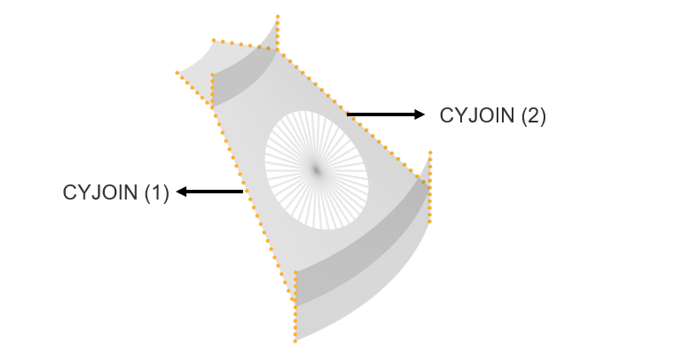

| CYJOIN | Specifies grid points on the segment boundaries that connect to adjacent segments. |

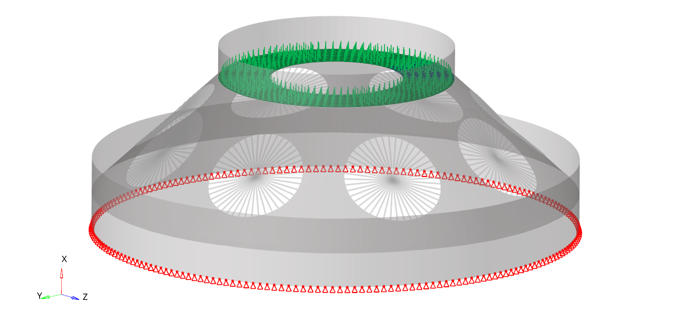

Problem Setup
$ EXAMPLE TO DEMONSTRATE A CYCLIC SYMMETRIC ANALYSIS SETUP
NOUTPUT = ALL
SUBCASE 101
SPC = 1
LOAD = 14
SUBCASE 102
SPC = 1
METHOD(STRUCTURE) = 2
HARMONICS = 102
BEGIN BULK
$--1---><---2--><---3--><---4--><--5---><--6---><---7--><--8---><---9-->
CORD2C 11 0 0.0 0.0 0.0 0.0 0.0 1.0
+ 1.0 0.0 0.0
EIGRL 2 0.0 50 MAX
SET 102 MODE
+ 0 1
CYSYM 4
CYJOIN 1 12 THRU 20
CYJOIN 2 22 THRU 30
GRID …
FORCE 51 12 11 1.0 0.0 100.0 1.0
LOADCYN 14 0.1 2 1.0 51
LOADCYN 14 0.1 4 1.0 51

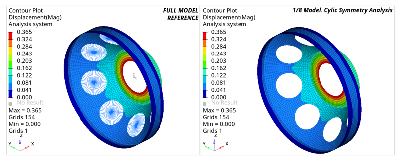

View Results in Cyclic Symmetry Analysis
Systems referenced by the CD field of grid points in the basic segment (including the basic coordinate system when CD is blank) is cyclically patterned and assigned to corresponding grids in each segment requested by NOUTPUT. This can also be used for viewing the results for each segment in its local coordinate system.
To view results in the basic coordinate system, The “Global coordinate system” option can be selected in HyperView.
