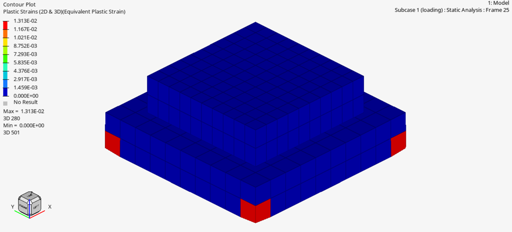

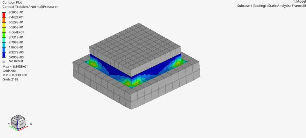

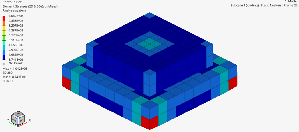

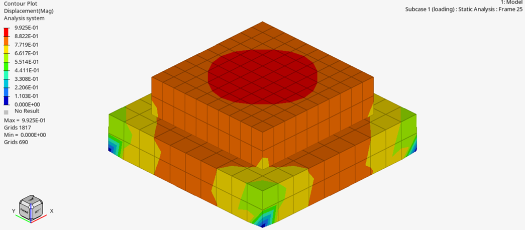

Plot the Displacement, the von Mises stress, plastic strains and contact
pressure contours at the end of the first (loading) step.
Figure 11. Contour of Displacements in Blocks Subject to Loading Figure 12. Contour of von Mises Stress in Blocks Subject to Loading Figure 13. Contour of Plastic Strains in Blocks Subject to Loading Figure 14. Contour of Contact Pressure in Block Interface after the First
(Loading) Subcase

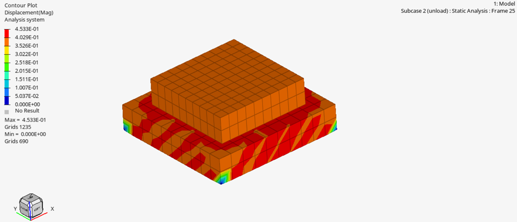

Change the subcase to the second (unloading) subcase and plot the displacement
contour to see the change in displacements in the blocks subject to
unloading.
Figure 15. Contour of Displacements in Blocks Subject to Unloading in Second
Subcase
