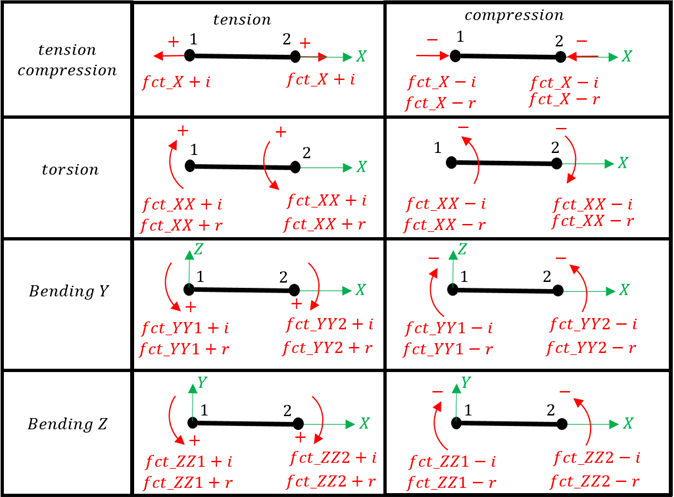

| fct_X+i | Tensile force function
versus strain in X-direction. (Integer) |
| fct_X-i | Initial compression force
function versus strain in X-direction. Used for elements in the
initial state. 4 (Integer) |
| fct_X-r | Residual compression force
residual state. 4 (Integer) |
| Fscale_XY | Ordinate scale factor for
tensile functions. Default = 1 (Real) |
| fct_XX+i | Initial torsion moment
function versus torsion angle in the positive direction. Used for
elements in the initial state. (Integer) |
| fct_XX-i | Initial torsion moment
function versus torsion angle in the negative direction. Used for
| fct_XX+r | Residual torsion moment
elements in the residual state. (Integer) |
| fct_XX-r | Residual torsion moment
| Fscale_XXY | Ordinate scale factor for
torsion moment functions. Default = 1 (Real) |
| fct_YY1+i | Initial bending Y moment
function versus bending angle in the positive direction for node 1.
Used for elements in the initial state. (Integer) |
| fct_YY1-i | Initial bending Y moment
function versus bending angle in the negative direction for node 1.
| fct_YY1+r | Residual bending Y moment
Used for elements in the residual state. (Integer) |
| fct_YY1-r | Residual bending Y moment
| Fscale_YY1Y | Ordinate scale factor for
bending Y moment functions for node 1. Default = 1 (Real) |
| fct_ZZ1+i | Initial bending Z moment
| fct_ZZ1-i | Initial bending Z moment
| fct_ZZ1+r | Residual bending Z moment
| fct_ZZ1-r | Residual bending Z moment
| Fscale_ZZ1Y | Ordinate scale factor for
bending Z moment functions for node 1. Default = 1 (Real) |
| fct_YY2+i | Initial bending Y moment
function versus bending angle in the positive direction for node 2.
| fct_YY2-i | Initial bending Y moment
function versus bending angle in the negative direction for node 2.
| fct_YY2+r | Residual bending Y moment
| fct_YY2-r | Residual bending Y moment
| Fscale_YY2Y | Ordinate scale factor for
bending Y moment functions for node 2. Default = 1 (Real) |
| fct_ZZ2+i | Initial bending Z moment
| fct_ZZ2-i | Initial bending Z moment
| fct_ZZ2+r | Residual bending Z moment
| fct_ZZ2-r | Residual bending Z moment
| Fscale_ZZ2Y | Ordinate scale factor for
bending Z moment functions for node 2. Default = 1 (Real) |

- This property is linked to two node spring elements.
- Kinter is used to calculate interface stiffness when the frame element is referred in a contact.
- If Icoupling =1, moments generated by forces are accounted in the global moment balance for each frame element (similar to Iequil =1 flag for spring /PROP/TYPE8 (SPR_GENE)).
- To reproduce buckling behavior of a chain of the crushable frames, it is assumed that each element can be either in initial state or in residual state (collapsed). Initially all crushable frame elements are in the initial state and corresponding "initial" force strain curves are used. When the strain becomes higher than the limit X_lim_g for a particular element, the element is switched into residual state. Afterwards, only "residual" force strain curves are used for this element for all DOFs. At the same time, information is sent to the attached frame elements (left and right, defined with property TYPE44 only) and all directions on the both nodes of these elements switch to the residual state.
- When the value X_lim and/or XX_lim are reached, all DOFs on the both elements nodes switch to the residual state. Neighboring elements also switch to residual state.
- When the value YYi_lim and/or ZZi_lim are reached, all DOFs linked to the node of the element, i switch to residual state. Neighboring element, which share the node, also switch to residual state.
- The function fct_X+i or fct_XX+i is linked to both nodes of the frame element.
- If skew is defined in the
property, the Z-direction is:
- If no skew frame is assigned in the property set, the Z-direction
is:
