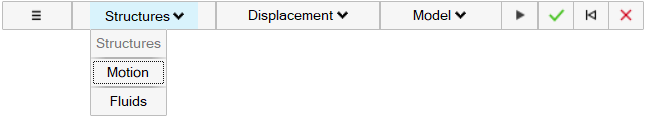

Use the dropdown menu on the guide bar to select the
model type for which you want to create responses.

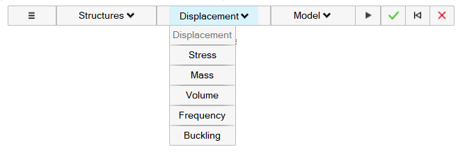

type of response you want to create.

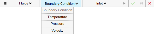

Figure 2. Response types for Fluids
