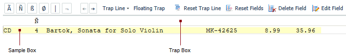

You create a trap by entering trap characters in the Trap box (immediately below the row of buttons in the Template Definition dialog):
The Sample Box and the Trap Box. The trap box has one numeric trap defined.
You can specify one or more trap characters on the trap line. Often, several different combinations will work equally well. It is generally a good idea to specify several trap characters to insure that you do not accidentally capture lines from other sort levels, but be careful. If you specify many trap characters, you run the risk that some lines will be missed by the trap. You can experiment with the trap definition until you find a combination that works.

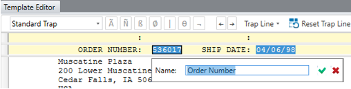

      Using the Context Menu Follow these steps to name or rename a field via the context menu: -
          Right-click on a field and select Rename: The Field Name Editor dialog box displays:
          Enter a new name.
          Press Enter (or click the green check button). This will close the name edit control and update the Field Properties.
