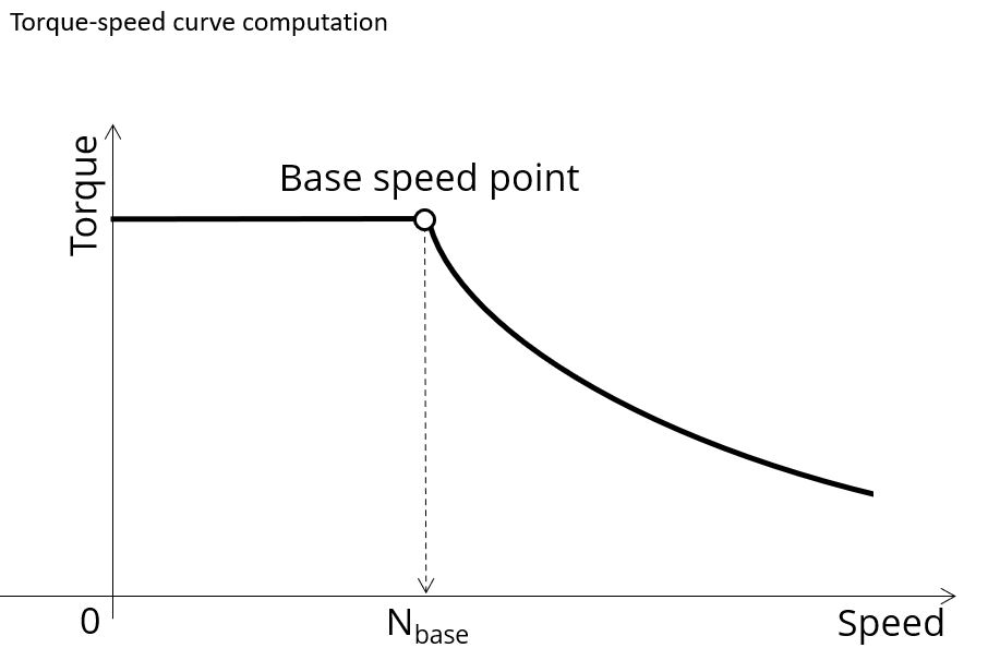

| Characterization of the corner point on the torque-speed curve |

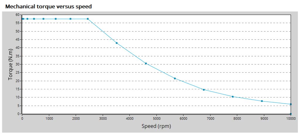

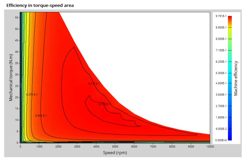

In the results, the performance of the machine at the base point (the base speed point) and for the maximum speed set by the user are presented. A set of curves (like Torque-Speed curve) and maps (like Efficiency map) are computed and displayed.

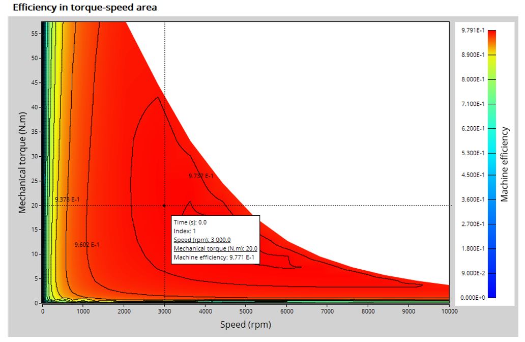

Here are below illustrations of some results that can be provided in the test.
| Mechanical torque versus speed - Example |
| Efficiency in torque-speed area - Example |
| A “single” working point displayed on the efficiency map - Example |

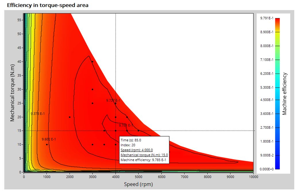

The second feature allows the user to define a duty cycle by giving a list of working points (speed, torque) versus time. The displayed results illustrate the machine performance over the considered duty cycle (mean, min, and max values).
The time variation of the main quantities is also displayed (mechanical torque, speed, control angle, current, voltage, power, efficiency, and losses).
All the corresponding points are displayed on the different map provided. Each working point can be selected to visualize the corresponding main information.
| A “Duty cycle” displayed on the efficiency map - Example |

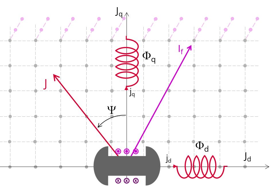

The first step consists of computing the raw data that characterizes the machine in the three dimensions If - Jd - Jq. This is done using Finite Element modelling (Flux® – Magnetostatic application).
To do that, a grid of values (Jd, Jq) is considered for all levels of If.
For each node of this grid, the corresponding flux linkage through each phase is extracted (a, b, c). Fux density in regions (teeth and yoke of the machine) is also extracted.
| Raw data – Test “Performance mapping – Sine Wave – Motor – Efficiency map” |
The second step consists of using the raw data with Park’s model.
D-axis flux-linkage component (d) and Q-axis flux-linkage component (q) are computed according to the Park’s transformation.

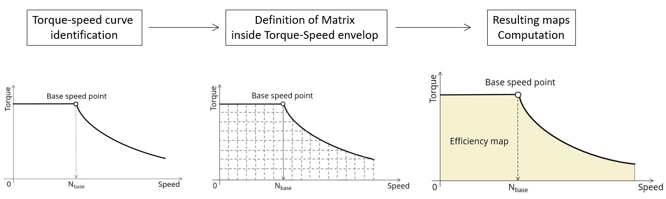

Identification process for the torque-speed curves and maps
Below are the three main steps involved in building the efficiency map and other associated results.
- Building of the torque-speed curve and other associated results
- Define the grid in the area under the torque-speed curve
- Building of the efficiency map and other associated results
| Main steps of the computation algorithm |

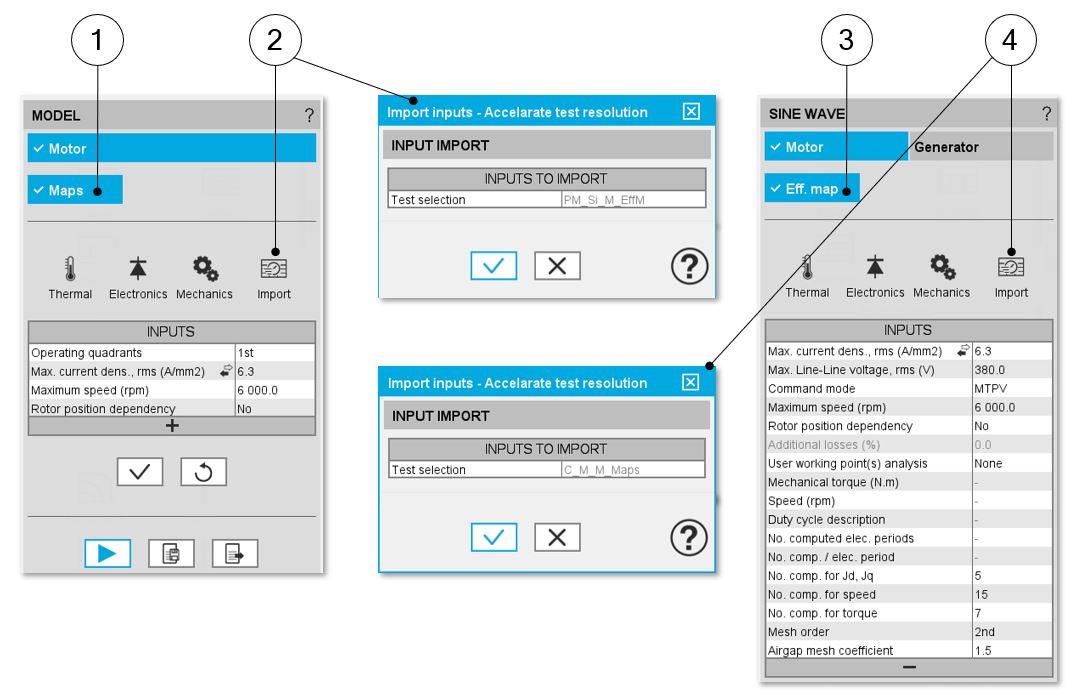

The import button allows sharing the data simulated in Flux between model map and efficiency tests.
By implementing the rotor position dependency option for the model map test and efficiency map test of synchronous machines, this update facilitates the seamless transfer of settings, inputs, and crucially, simulated data in Flux between the two tests. As they use the same Flux data in most cases and significant computation time is required to obtain it, users can now accelerate the test resolution and optimize their workflow.
- Reluctance Synchronous Machines - Inner rotor
- Synchronous Machines with wound field – Inner Salient Pole - Inner rotor
Upon completing a model map test, users can activate the import button in the efficiency map test GUI. This enables them to effortlessly import the settings and corresponding Flux data from the previous test, eliminating the need to rerun Flux for identical data, a step that typically consumes a substantial portion of computation time during efficiency mapping.
| Import function in Model Map test and Efficiency Map test to accelerate test resolution | |
| 1 | Open model map test environment when an efficiency map test is available for import |
| 2 | Click the import button and import the settings, inputs, and Flux data of the latest efficiency map test |
| 3 | Open efficiency map test environment when a model map test is available for import |
| 4 | Click the import button and import the settings, inputs, and Flux data of the latest model map test |
