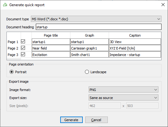

  1. On the Reporting tab, in the Reports group, click the  Generate quick report icon.
    Figure 1. The Generate quick report dialog.
  2. From the Document type drop-down list, select one of the following:
    • MS PowerPoint (*.pptx)
    • MS Word (*.docx *.doc)
    • PDF (*.pdf)
  3. In the Document heading field, specify the report title.
  4. In the table, specify the page titles, graphs to include and the graph captions.
  5. For Microsoft Word and PDF reports, specify the Page orientation.
  6. From the Image format drop-down list, select one of the following:
    • PNG
    • BMP
    • CUR
    • ICNS
    • JPG
    • PBM
    • PGM
    • TIF
    • WBMP
    • WEBP
    • PDF
    • EPS
    • EMF
  7. From the Export size drop-down list, select one of the following:
    • Same as source
    • QQVGA (160x120)
    • QVGA (320x240)
    • VGA (640x480)
    • SVGA (800x600)
    • XGA (1024x768)
    • SXGA (1280x1024)
    • Custom
  8. Click Generate to generate the report.

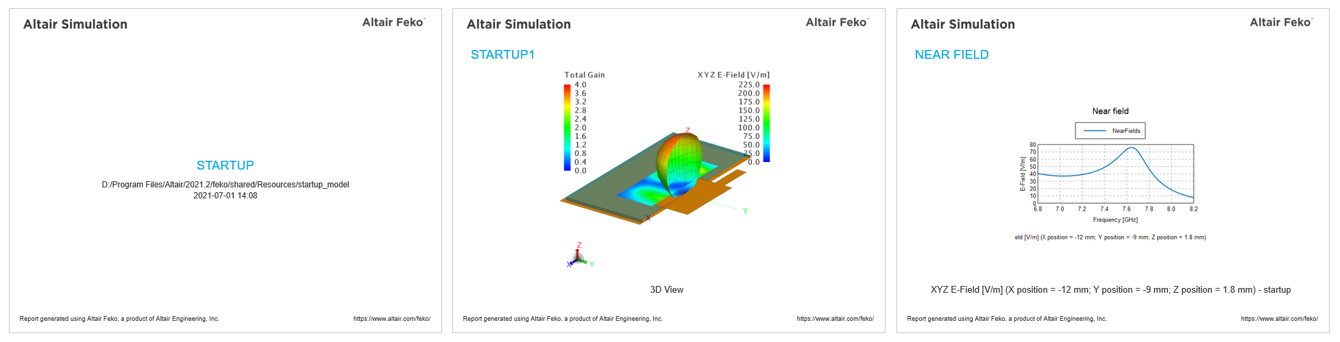

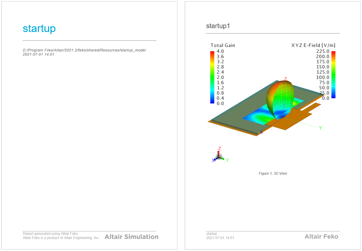

    Figure 2. Example showing the Feko template for the quick report (Microsoft Word document).
    Figure 3. Example showing the Feko template for the quick report (Microsoft PowerPoint document).
