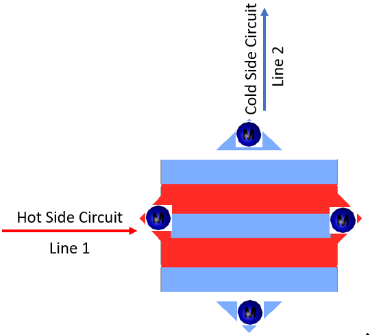

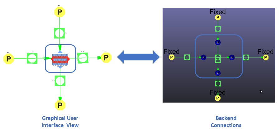

  • The Hot Side circuit must get connected to Line 1 (Indicated by Red Color part of Component Image) and Cold Side circuit get connected to Line 2 (Indicated with Blue Color part of Component Image) as shown in the image below.
    Figure 3.
  • You can choose to model additional inlet and outlet losses using the separate Discrete Loss/Tube Element upstream and downstream of heat exchanger respectively.
  • The Hot/Cold Side circuit line must be connected with either compressible or Incompressible set of elements. Mixing of elements sets for a Hot/Cold side circuit line is not allowed. Below Table represents some modeling/allowable scenarios.

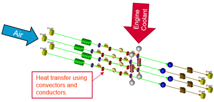

Flow Simulator can also be used for Heat Exchanger design. For heat exchanger design a detailed representation of the heat exchanger is required. The example below shows flow elements representing the cold and hot side with thermal network resistors connecting the sides. Heat exchanger performance can be predicted from such a model.
