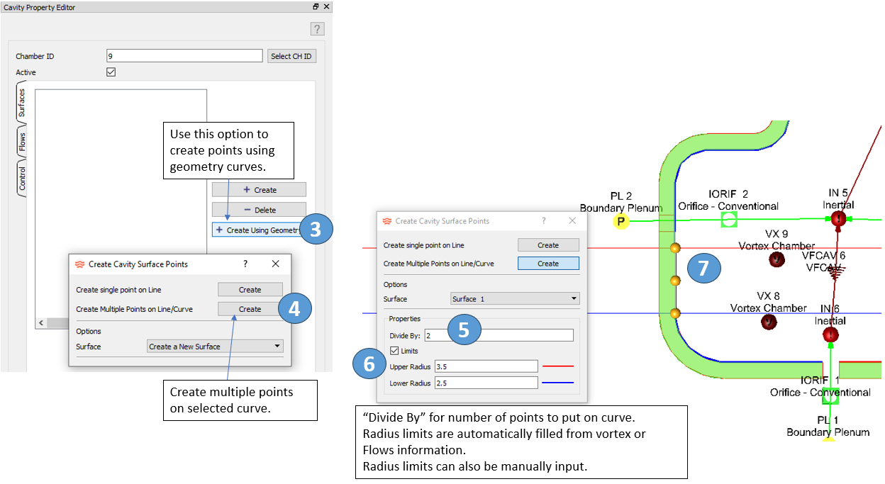

- Create the surfaces of the cavity. Cavities usually have multiple surfaces, with each surface associated with a different part in the machine. Each surface must have a unique speed so do not use points from a rotating and stationary part on the same cavity surface. Cavity surface points can be created using 1)the traditional approach of selecting a point on the screen close to the CAD geometry or 2) using the CAD geometry to place points directly on the curves.
- The Create option works best for creating a new
surface with the traditional approach. Use the
Insert, Move, and
Delete options to edit an existing surface.
Select the surface points on the screen to fully define the cavity
surface.
- Create surface points directly on the CAD geometry one at a time.
Figure 3.
- Create multiple surface points directly on the CAD geometry with one
click.
Figure 4.
