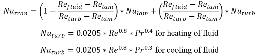

Heat Transfer Correlations:

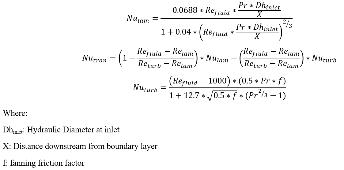

Lapides-Goldstein:

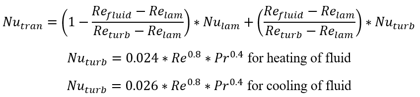

Dittus-Boelter:

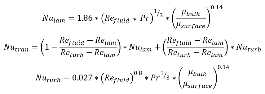

Sieder-Tate:

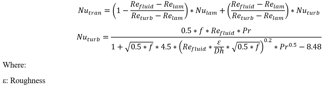

Gnielinski:

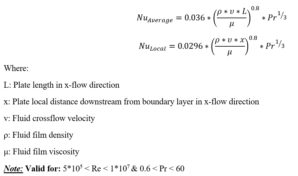

Colburn (Plate in Cross Flow):

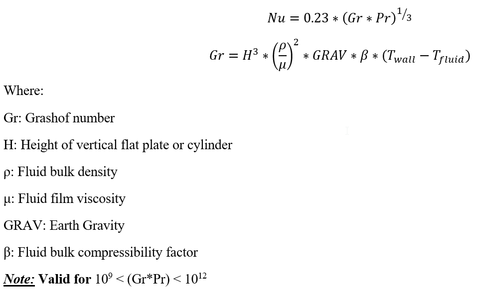

McAdams (Vertical
Prism in Free Convection):

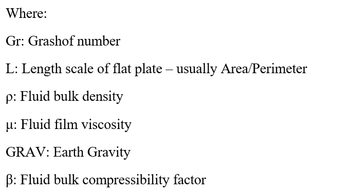

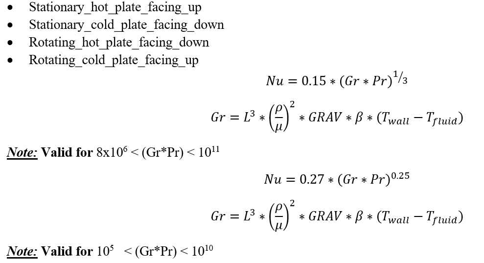

Horizontal Plate
in Free Convection:

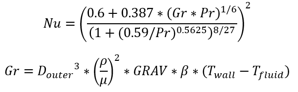

Churchill-Chu(Horizontal Cylinder in Free Convection):
Where:
Gr: Grashof number
Douter: Cylinder outside diameter
ρ: Fluid bulk density
μ: Fluid film viscosity
GRAV: Earth Gravity
β: Fluid bulk compressibility factor
Note: Valid for 106 < (Gr*Pr) <
1012

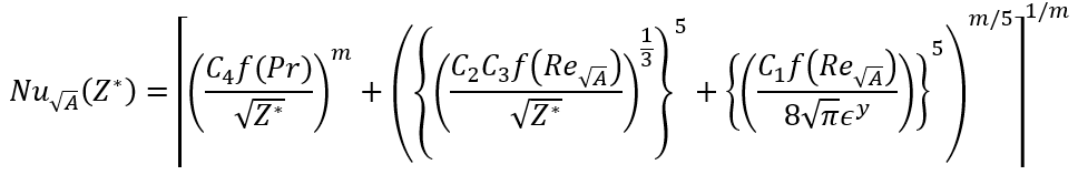

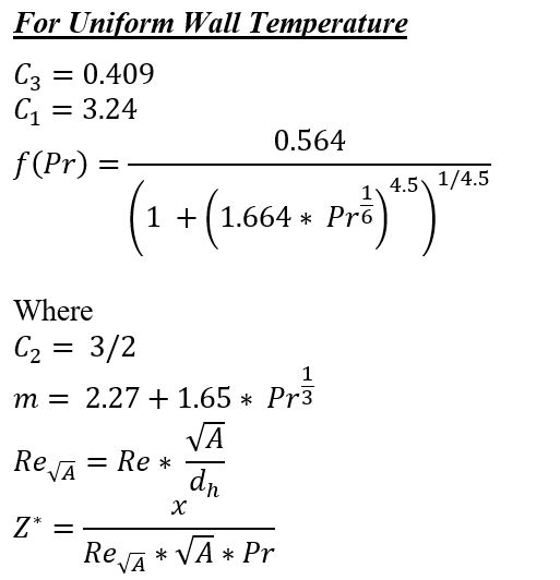

Laminar Duct Flow HTC correlations
The
following Laminar HTC options are available in Flow Simulator. It is worth noting
that Laminar HTCs depend on distance from inlet x, and thus do not need a special
Entrance Effects multiplier.

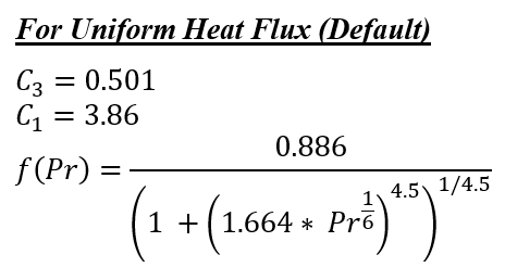

Muzychka-Yovanovich:

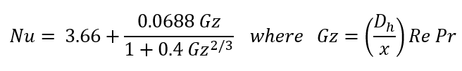

Hausen:
