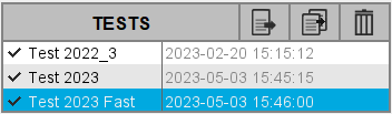

The accesses via the table list of tests is already existing.

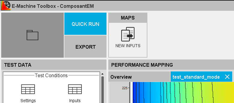

For more accessibility and visibility, these functions on the selected test have been added on the top.
The both possible accesses are always available.
Steps for Export functions
To export a test:
- Open your FEMT component previously computed

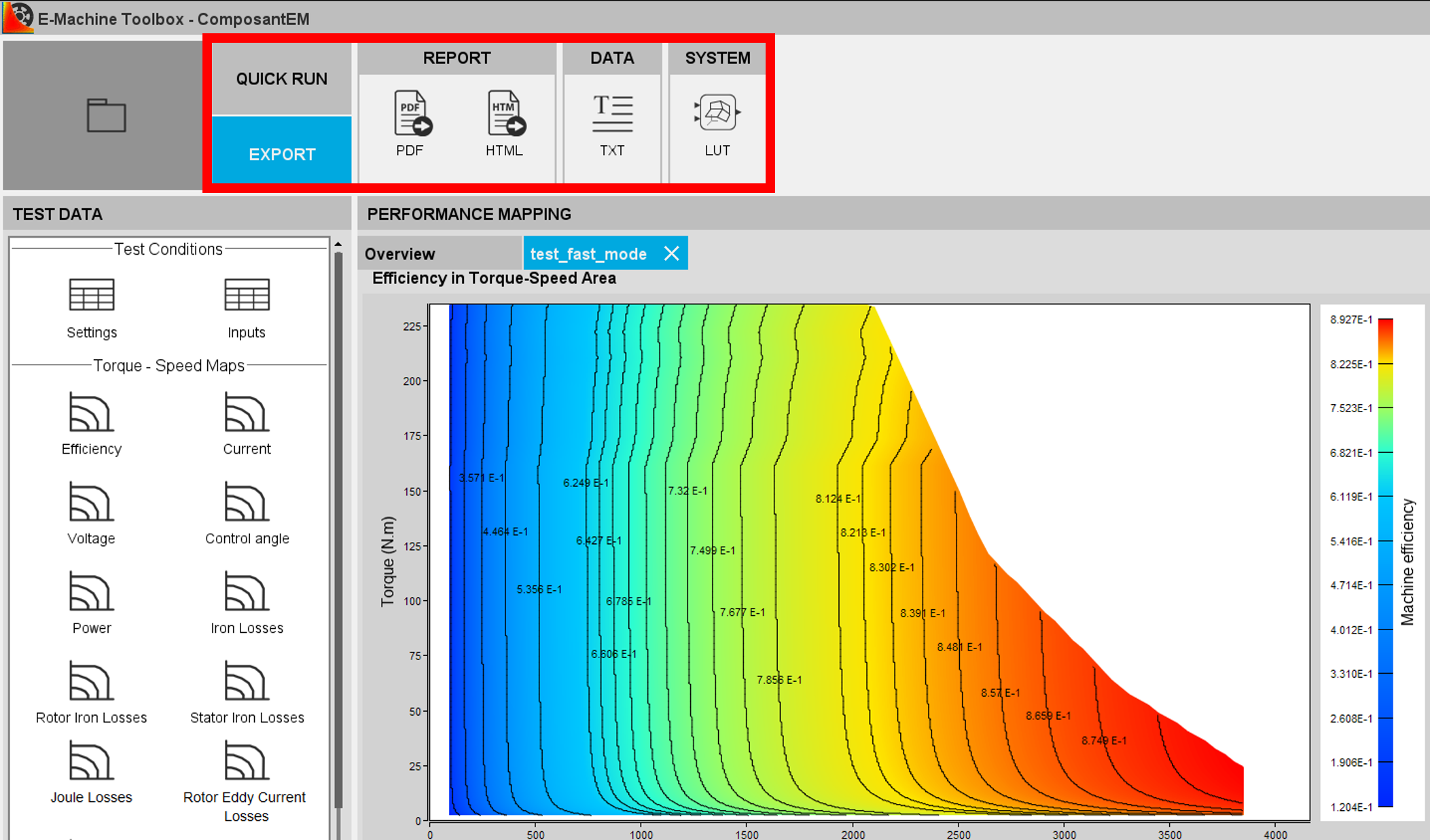

- Display the test by double clicking on it

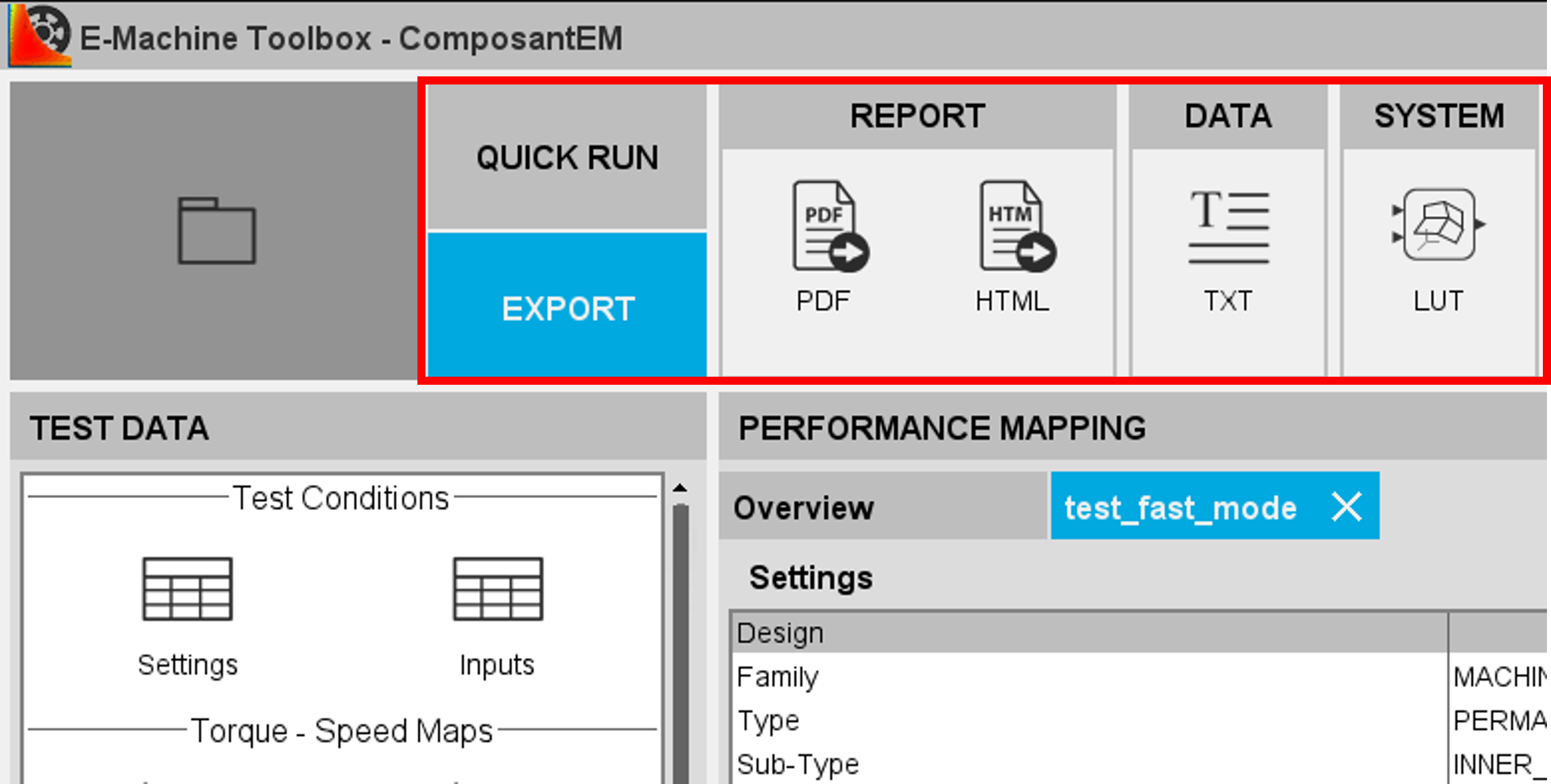

→ the test is displayed in the central area and the ribbon bar of possible functions appears at the top
Click on EXPORT
Click in the export format you want (PDF or HTML or TXT or LUT)

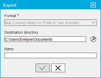

→if you choose for example LUT, the dialog box is opened to MAT export

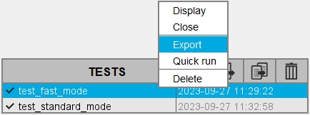

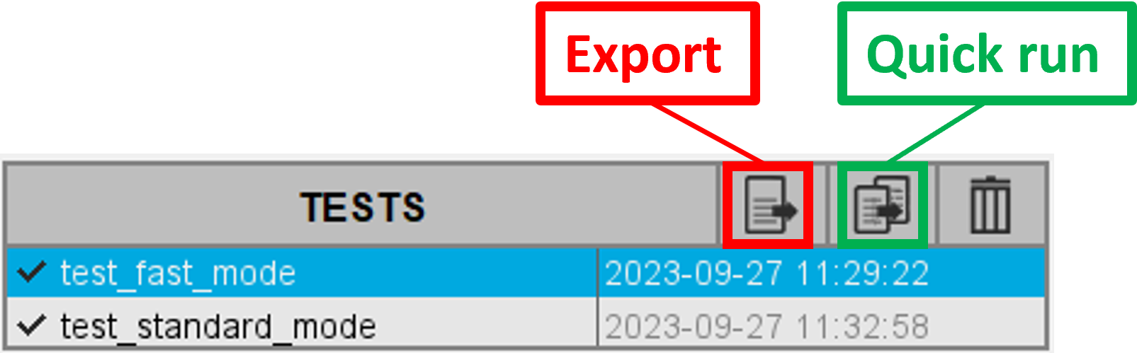

Note: The access to this dialog box can be also:- by clicking on the button Export (the
button in the red rectangle below)
- or Select the test and do a right click on the test and click on
Export

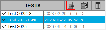

- Choose the Destination Directory
- Choose a Name
- Validate the dialog box
Click on QUICK RUN
Click in

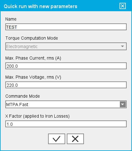

- Open the Quick run with new parameters dialog box:Note: It's also possible to open the Quick run dialog box:
- by selecting the test in the list and by clicking on
- or by a right-click on the test and by selecting in the contextual menu → Quick run
→ the dialog is opened
- Fill the fields with the new customs values and validate
→ a new test is automatically created in the TESTS table and the maps are generated in few seconds
