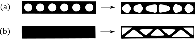

In Free-shape optimization, the boundaries of selected parts of an initial design are iteratively displaced and modified by the procedure. The result is an improved shape that satisfies the optimization criteria and that usually resembles the original design. Topological optimization methods, on the other hand, are based upon the addition or removal of the matter composing the parts being optimized. This process is governed by the evolution of the values of a material density function throughout the optimization procedure, and frequently leads to quite innovative shapes that may not have been previously considered. Figure 1 illustrates both approaches in the simple case of the optimization of a beam.
Figure 1. Comparison of free-shape (a) and topology (b) optimization strategies in a simple structural mechanics example (the structural optimization of a beam).
