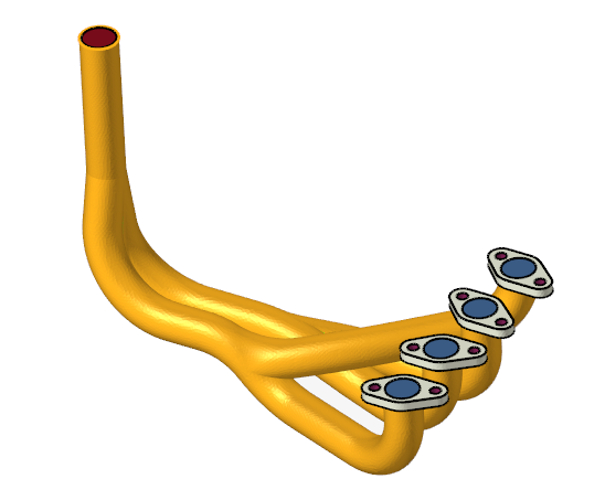

Problem Description
The diameter of the inlets is 0.036 m; the inlet velocity (v) is 8.0 m/s; and the temperature (T) of the fluid entering the inlets is 700 K. The diameter of the outlet is 0.036 m. The pipe wall has a thickness of 0.003 m and the flanges have a thickness of 0.01 m.
The combustion mixture enters the inlets and heat is transferred through conduction inside the manifold. The heat transfer causes deformations and stress in the manifold body which can be simulated using OptiStruct.

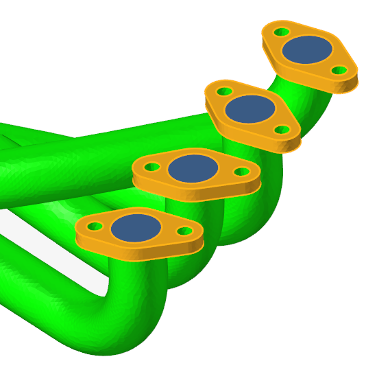

Click the No Slip tool.
Select the wall flanges.
Figure 18.
Note: Make sure you select the bottom and side surfaces of the flanges. In total, 12 surfaces should be selected. -

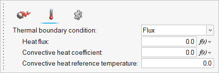

In the microdialog, click the
Temperature tab, set the Convective heat coefficient
to 100, and the Convective heat reference temperature to
303.
