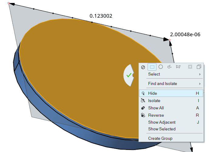

  5. Select the surface highlighted in the figure below and hide it by pressing the H key or by right-clicking and select Hide from the context menu.
    Figure 47.
  6. Select the three surfaces highlighted in the figure below.
