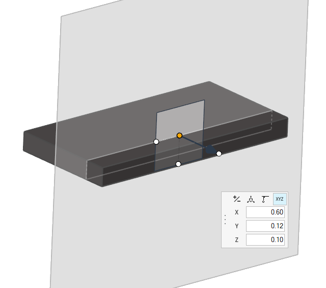

Define Nodal Initial Conditions
From the Solution ribbon, click the
Plane tool.
- Select the solid body.
- Click Plane on the guide bar.
- Click any point on the model to initially position the plane.
Click
in the microdialog and manually set the plane axis to Y.
Click
and set the coordinates to (0.60, 0.12, 0.10).
- Press Esc two times.
Click
to add a variable then select Fluid from the list.
Make sure that the Value is set to Water then press
Esc again.
