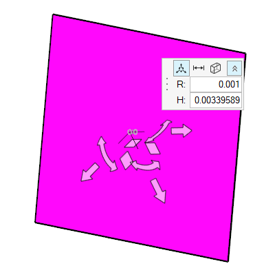

- To provide the dimensions of the cylinder, right click on Nodal initial condition cylinder in the legend and select Edit.
In the microdialog, click the icon on the right to
expand the menu, then set the radius to 0.001 and the
height to 0.00339589
