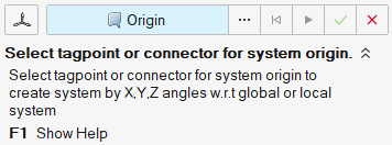

- Next to the LCS Create tool, click the arrow to display a drop-down menu. Select the LCS type to create: Axis-plane, Angle, or Ujoint.
- A guide bar opens, which contains the options to create the LCS type.
Figure 2. Angle type guide bar

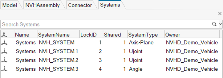

- Review the LCS list in the Systems Browser.
- To delete a LCS, select the row corresponding to it, right-click, and select
Delete from the context menu.
Figure 3.
- To edit a LCS, select the row corresponding to it and click the fields that need to be edited
