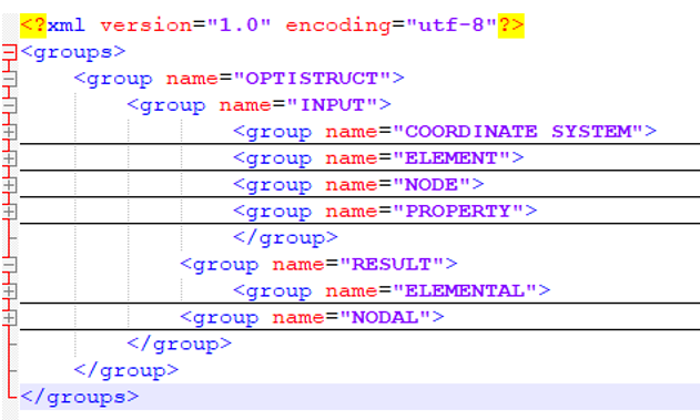

Data Types
<typedef>,
<group> and <dataset>. The following is
a brief overview of the structure of HDF5 data in OptiStruct.
Supported Group Names
The data in an HDF5 file is hierarchically structured in the form of groups. The most basic form of data in the tree is called a dataset. The following tables summarize the currently supported groups and their relevant datasets.
OptiStruct INPUT Group
