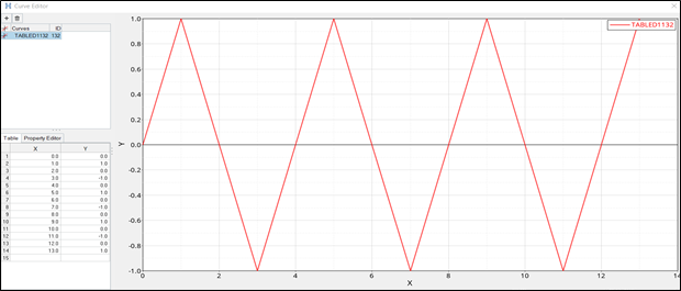

The cyclic plasticity concerns an elastoplastic stress–strain response of materials in closed and repeated loading paths. Among the cyclic plasticity phenomena, ratcheting can result in the additional damage of materials and the shortening of their fatigue life. Ratcheting is defined as a progressive strain accumulation in a material under stress-controlled cycling loading with nonzero mean stress. The specimen is constrained at the left end in the longitudinal direction, and an enforced displacement is applied to the right end of the specimen. A time-dependent enforced displacement is used (Figure 2).
Figure 2. Time-dependent Enforced Displacement

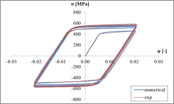

The results compare experimental and numerical stress-strain curves for the Chaboche model after optimization by the least-square method.
Figure 3. Reference Result

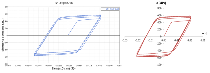

The elemental stress versus strain graph OptiStruct result (Left) and the experimental stress-strain curve for PA6 aluminum (Right) are shown in Figure 4 .
Figure 4. OptiStruct Result
The results obtained in OptiStruct, using a combined hardening material model, are similar to the experimental result.

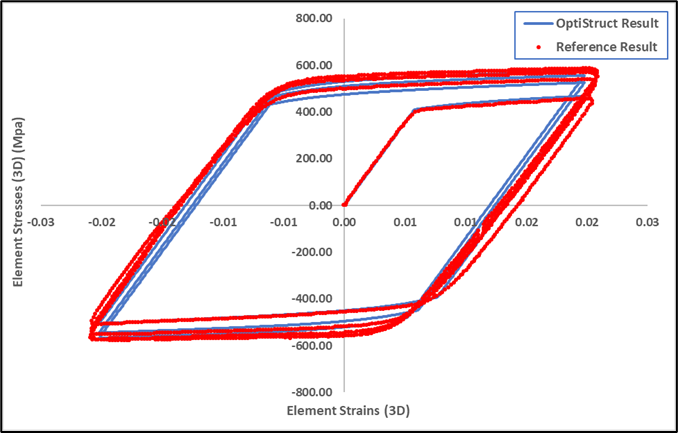

Figure 5. Superimpoased Reference and OptiStruct Result
Figure 5 shows the match between the OptiStruct results and the reference results. The OptiStruct result curves follow perfectly with reference result curves.
