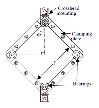

A picture frame test determines the fabric material behavior in shear.
Figure 1. Picture Frame Shear Rig

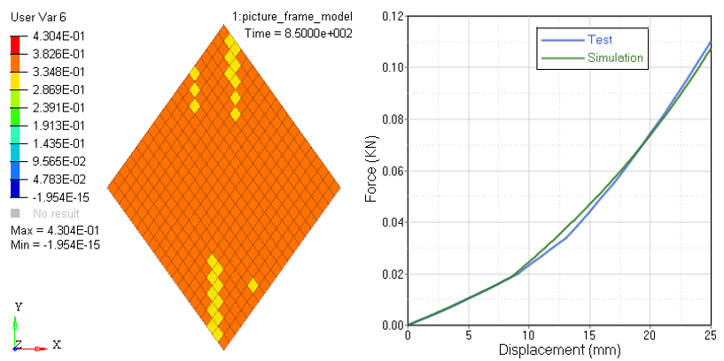

The shear stress as a function of the anisotropy angle in degrees should be extracted from the force displacement curves from the picture frame test and used as input curve in material LAW58.

Figure 2. Picture Frame Simulation and Shear Stress as Function of Anisotropy Angle

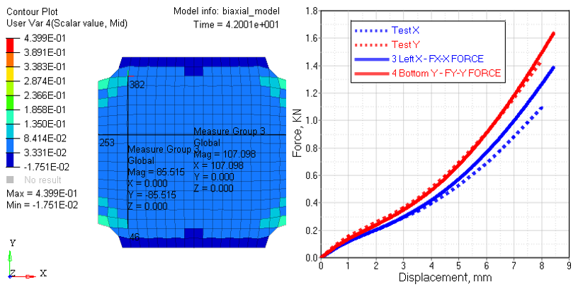

The biaxial test determines the LAW58 stiffness in weft and wrap directions.
Figure 3. Biaxial Simulation and Forces Displacement Curves in Warp and Weft Directions
The force displacement curves for warp and weft direction can be recalculated into stress and strain curves using size and thickness of the specimen. Due to corner boundary effects, slight scaling or other tuning of the input curves may be necessary.
