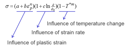

In LAW2 there are three parts to the stress calculation.
Influence of plastic strain
Influence of strain rate
Influence of temperature change

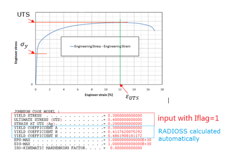

There are two ways to input material parameter for LAW2.
Iflag=0: Classic input for Johnson-Cook parameter , , is active
Iflag=1: New, simplified input with yield stress, UTS
(engineering stress), or strain at UTS
Iflag = 0
Where,
The yield stress which could be read from material test and
converted to true stress.
and
The material parameters. Fitting the material stress-strain
curve (for example, AltairCompose script) can result in
these two parameter.
Iflag = 1
With this new input, you will need yield stress
(), Ultimate tensile engineer stress (UTS) and
engineer strain () at necking point. With this new input,
Radioss automatically calculates the
equivalent value for , and .Figure 2. Tension Test

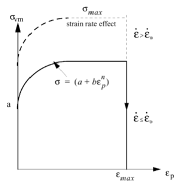

Strain Rate
Strain rate has a major effect of material character on crash performance in tensile
or in fracture. In Johnson-Cook theory, the yield stress is affected directly by the
strain rate and is described as:
Generally, yield stress increases with increasing the test strain rate. With the
strain rate coefficient, , you can scale the factor of yield stress increase.
No effect of strain rate could also be defined, if =0; or with or .Figure 3.

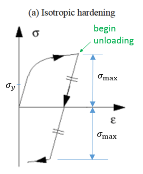

The value of Chard is from 1 to 0. Chard =0 for isotropic model, Chard=1 for kinematic Prager-Ziegler model, or between 1 and 0
for hardening between the above two models.
Chard = 0: Isotropic Model
In a one dimension case, material strengthens after yield stress. The
maximum stress of the last tension is the yield in the subsequent
loading, and this new yield stress is the same in subsequent tension and
compression.Figure 4.

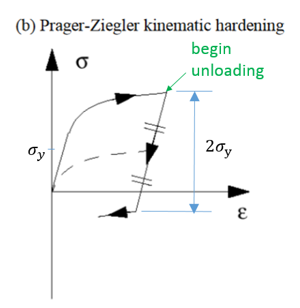

Chard = 1: Kinematic Prager-Ziegler Model
To model the Bauschinger effect (after hardening in tension, there is
softening in a subsequent compression which mean yield in compression is
decreased), use kinematic hardening.Figure 5.

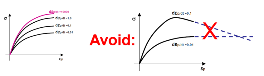

Elastic Plastic Piecewise Linear Material (/MAT/LAW36)
In LAW36, the numbers of plastic stress-strain curves can be directly defined for
different strain rates.
Plastic stress-strain of high strain rate should always be above the lower plastic
stress-stain curve.Figure 6.

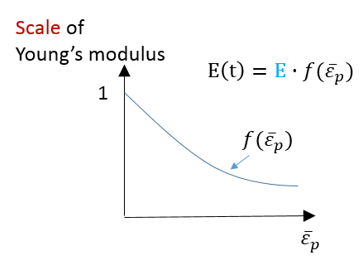

Young's Modulus
Young's modulus can be updated (decreased) in unloading with options fct_IDE, Einf and CE. Using this
feature improves the accuracy of spring-back (in unloading phase) for high strength
steel. This feature is also available in material LAW43, LAW57, LAW60, LAW74 and
LAW78.
Use fct_IDE to update the Young's modulus (fct_IDE ≠ 0): Figure 7.

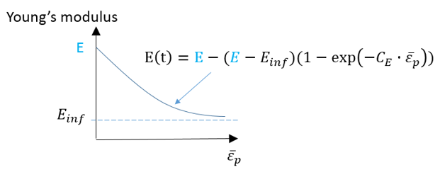

Use Einf and CE to
update the Young's modulus (fct_IDE = 0): Figure 8.

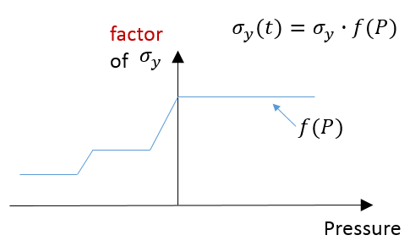

fct_IDp is used to distinguish the behavior in tension and
compression for certain materials (pressure dependent yield). The effective yield
stress is then obtained by multiplying the nominal yield stress by the yield factor
corresponding to the actual pressure.Figure 9.

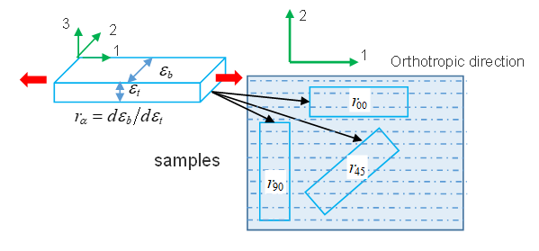

The Lankford parameters is the ratio of plastic strain in plane and plastic
strain in thickness direction .
Where, is the angle to the orthotropic
direction 1.
could be measured with different samples which cut
in different angle with orthotropic direction 1. Like measured from tensile test in which the loading
direction is along the orthotropic direction 1. measured from tensile test in which the loading is
perpendicular to orthotropic direction 1.
The strain ratio is the strain in width direction of sample to strain in thickness
direction of sample.Figure 10.
