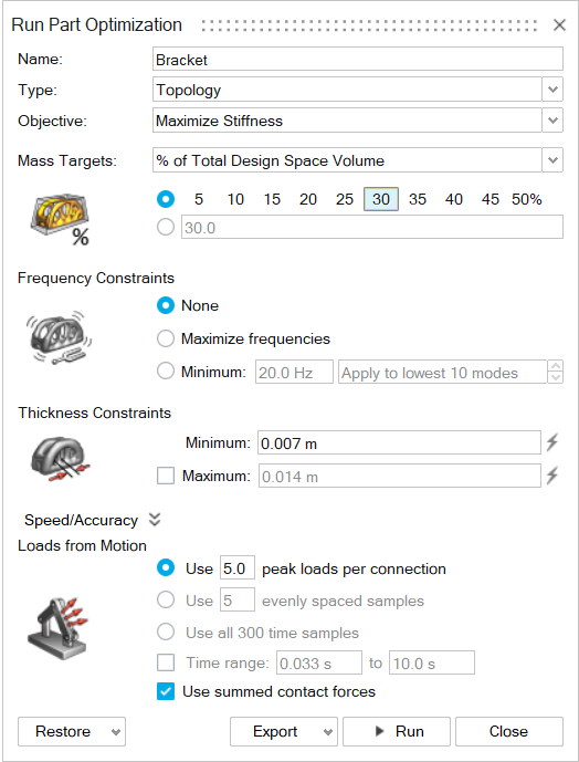

Select a design space to optimize. The Run Part
Optimization window appears.
- The Name of the run defaults to the name of the part, but you can enter an alternate name in the text entry field.
- Select what Type of optimization to run. (See optimization types.)
- Select an optimization Objective. (The optimization objectives will change based on what was selected for the run Type.)
- Define optimization constraints. (The constraint options will change based on which Type and Objective you select.)
- Select a preference for Speed/Accuracy.
- Define which method to use when extracting the Loads from Motion.
- If at any time you want to restore the default options for the Run Part Optimization window, click Restore and select Defaults.

Loads from Motion
When you optimize a part using a motion run, the part is loaded from the results of the motion simulation. You can choose to select which points in time are optimized by extracting the peak loads, evenly spaced time samples, all time samples, or range of times.
- Use # peak loads per connection: This option will extract time samples where peak loads occurred during the previously run motion analysis. This is the default option.
- Use # evenly spaced samples: This option will extract evenly spaced time samples from the previously run motion analysis. This is useful for reducing the number of runs.
- Use all # time samples: This option will extract loads from all time samples from the previously run motion analysis. This is useful for capturing loads from an entire motion cycle.
- Time range # to #: Select the checkbox to define a time window to limit the number of samples. This can be applied to any of the three options above.
- Use summed contact forces: This option will use a Summed at Contact Region representation of the contact forces instead of the individual contact forces themselves.
