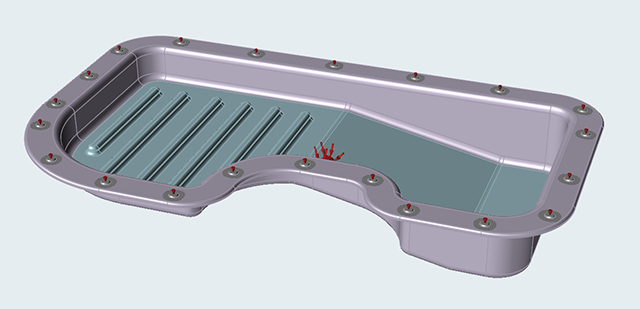

- Press F7 to open the Demo Browser.

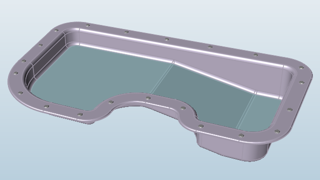

Double-click the baseline_oilpan.stmod file to load it in
the modeling window. Note that it has a pressure applied to the base part and is
restrained with fasteners at the bolt holes.

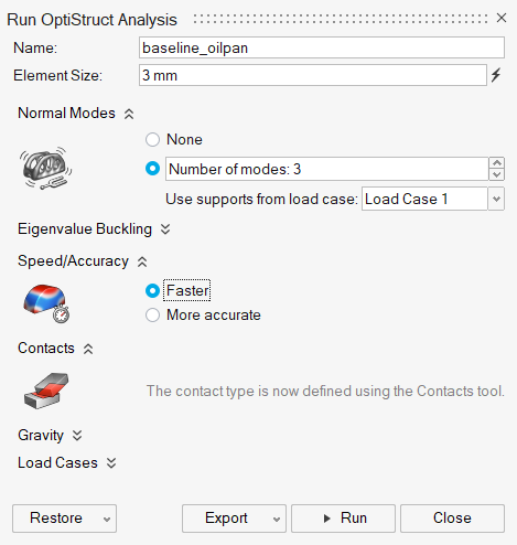

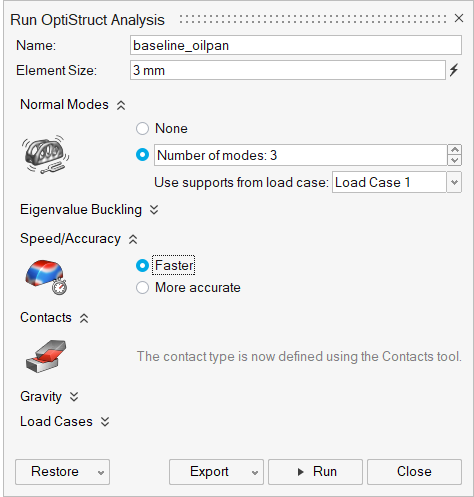

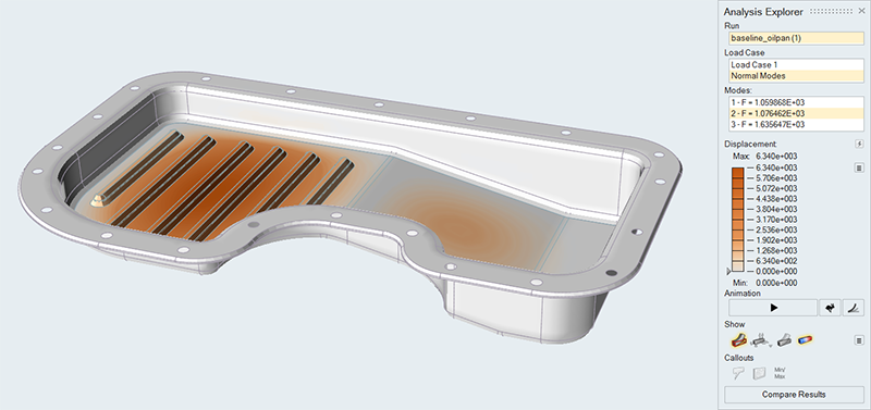

Set the options in the Run Analysis window as shown below:
- Change the Element size to 3 mm.
- For Normal modes, select Number of modes: 3 and use supports from Load Case 1.
- Make sure that Speed/Accuracy is set to Faster.

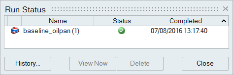

- Click Run to perform the analysis.
When the run is complete, double-click on the name of the run to view the
results.
In the Analysis Explorer, under the Show icons, select Hide all
loads and supports.
Select Normal Modes for the load case and review the
modes.
- Close the Analysis Explorer.

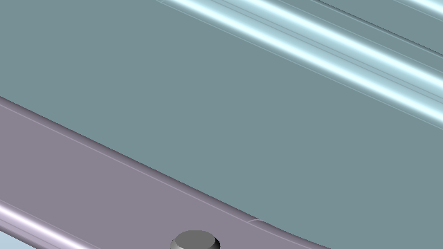

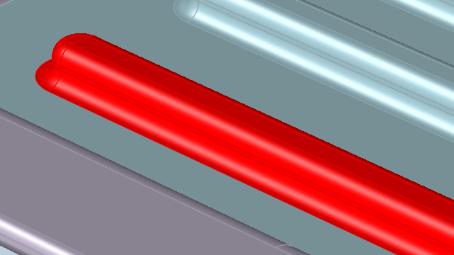

Zoom in on one of the beads and double-click one of the bottom fillets (nearest
the bottom of the oil pan).
This will chain select the entire bead.
Click on one of the selected red faces to remove the entire bead.
Repeat the procedure to remove the remaining beads on the oil pan.
- For Normal modes, select Number of modes: 3.

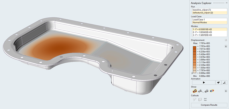

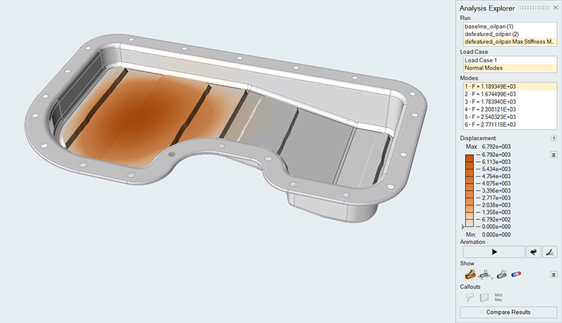

- When the run is complete, double-click on the name of the run to view the results.
In the Analysis Explorer, select Normal Modes for the
load case and review the modes.
Note: The local mode shape where the beads were removed dropped from 1076 Hz to 693 Hz.

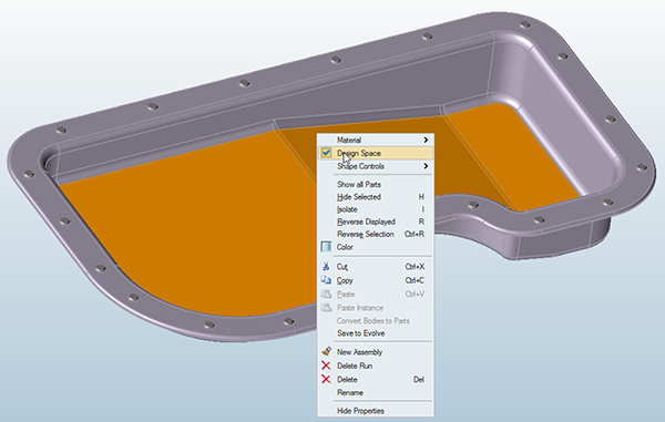

The next step is to define the design space and run a topography optimization.
Right-click on the base part to open the context menu, and select
Design Space.

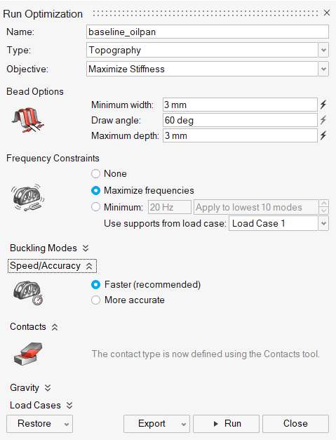

Set the options in the Run Optimization window as shown below:
- Select Topography for the Run Type.
- Select Maximize Stiffness for the Objective.
Set the following Bead Options:
- Minimum width: 3mm
- Draw angle: 60 deg
- Maximum depth: 3mm
- For Frequency Constraints, select Maximize frequencies and use supports from Load Case 1.
- Select Faster for the Speed/Accuracy.
- Click Run to perform the optimization.

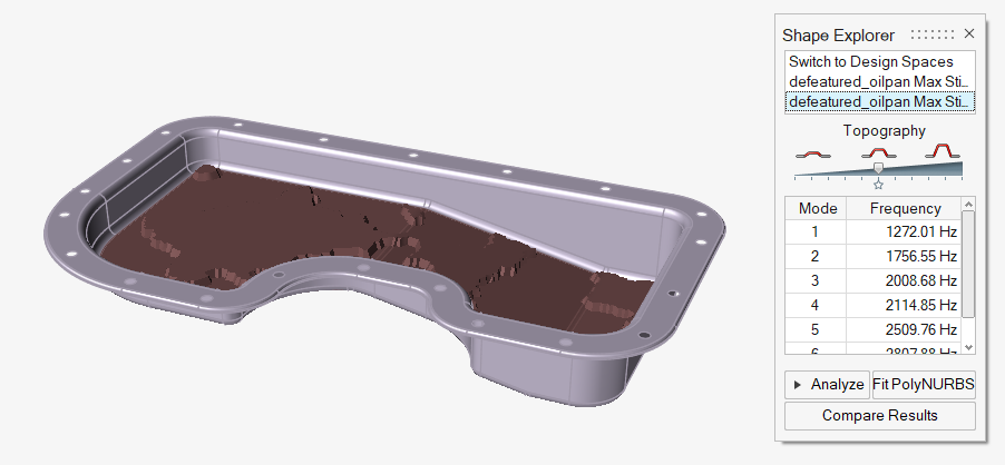

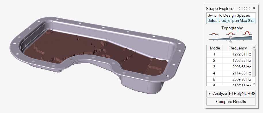

In the Shape Explorer, note that Mode 1 has risen to 1290 Hz with a lower bead
height than in the original part.
Note: Interpreting the results of topography optimization is often helped by performing multiple runs with different bead option parameters and bead patterns. This highlights key areas that benefit from the extra form and increased section modulus that typically result from topology optimization.

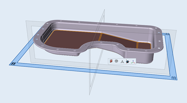

Select the Bead Pattern tool on the Structure
ribbon.
Select the Linear tool.
- Select the base of the oil pan.
Set the plane of symmetry as shown. Click the Rotate 90
Degrees
icon on the microdialog if needed to change the
direction of the beads.
Rerun the topography optimization with the same parameters as before:
Note: Note the linear alignment of the beads to the defined vector. Also note that Mode 1 is now 1176 Hz. This is better than the baseline result, but not as high as the initial optimization run.
